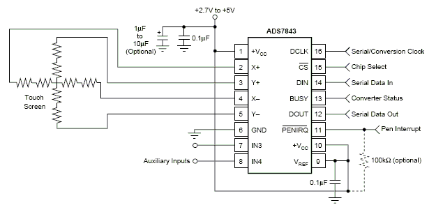

For the past few years I've been experimenting with electronics and have learned some of the basics, mostly from the internet and great sites like this one. Now I've come up against a project that's stretched past my abilities, so I figured I'd ask for some help.
I'm trying to build a touch controller for my 4-wire resistive touch screen LCD. I've got some Texas Instruments ADS7843 chips which are supposed to be able to convert the resistive touch screen to a serial output, using something similar to the following schematic (from datasheet)...
ads7843-gif.11740

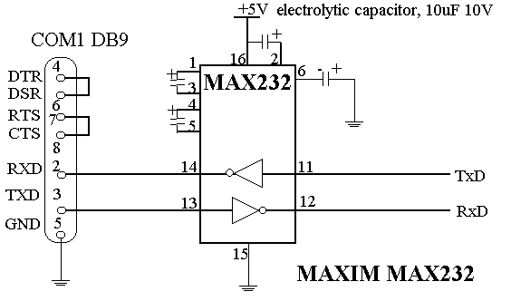

Now, as far as I can tell, I still need another chip to actually interface with my PC's serial (RS232) port. Enter the TI MAX232 chip, which can be hooked up something like this...
max232-gif.11741
So how do I interface the two? On the MAX232 looks like I need to supply TXD and RXD connections, but the ADS7843 chip has quite a few outputs:
- Serial/Conversion Clock
- Chip Select
- Serial Data In
- Converter Status
- Serial Data Out
- Pen Interrupt
I'm guessing that the TXD and RXD basically get connected to the Serial Data In and Serial Data Out. What about the other 4, Serial/Conversion Clock, Chip Select, Converter Status, Pen Interrupt?

It's probably easier to use a microcontroller to interface to the PC, or you could use the PC parallel port to connect the chip direct - the serial port isn't suitable as it's asyncronous, and the chip is syncronous plus other control lines.

You don't really - you write a program on the PC to create a syncronous serial port, with extra switching lines, to use the parallel port to control the IC. PIC programmers commonly work in a similar way.
If you used a PIC to interface it to a serial port, you would be writing a similar program in the PIC - there should be examples in the datasheet?.
Actually, I had no plans of using a microcontroller/PIC at all, unless you are referring to the MAX232 which is (AFAIK) just an IC to switch the levels to something usable by the PC's RS232 port, and not a PIC. Is that what you meant? Or am I completely missing something? :)
You need 'something' programmable, in order to drive the chip - like I said, you could use the parallel port and program the PC to do it. The MAX232 is just a level shifter and inverter.

I thought you were a PIC programmer?, all you need is a single resistor to connect a PIC directly to the serial port of a PC.
As practically all logic devices run on 3.3 or 5V, you’re going to damage either your motherboard or your micro if you don’t use a device to interface the two.
Hence the single resistor!.

Your confusion regarding the serial interface of this chip is understandable. The main point is that there's a difference between 'a serial interface' and the particular type of serial interface that a computer's serial port provides (RS232). Technically "serial" is a very broad term that can cover a lot of different communication protocols, but because people just say computers have a 'serial port' it's easy to assume that if any device has 'a serial interface' it'll be compatible with the computer's serial port, but that's not the case.

PIC's have protection diodes across MOST of the I/O pins, all you need is a single current limiting resistor and you can feed RS232 directly to the pin. The other way you can just connect the PIC pin directly, 0-5V works fine feeding the PC serial port.
However, as there's no hardware inversion, you MUST use a software UART rather than a hardware one. The BASIC STAMP uses this exact technique.

If you're using a UART though, you need inversion, so you may as well use a proper chip, which is 'nicer' anyway!.
