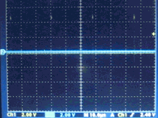

Here's the result (not that in the below images, the Yellow Channel is the raw PWM signal, and the Blue Channel is the filtered DAC output);
variable-20pwm-20duty-20cycle-gif.25610
It's a little hard to judge quality from that, so here's some other real life results;

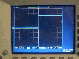

a) Switching from 0% to 100% duty instantly (with short pause in between);
max-20and-20min-20duty-20cycle-gif.25611

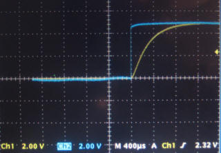

b) Closer look a the Time Constant charge time (image displays a ramp from 0% to 100% duty on a 400uS time base);
img45-jpg.25612

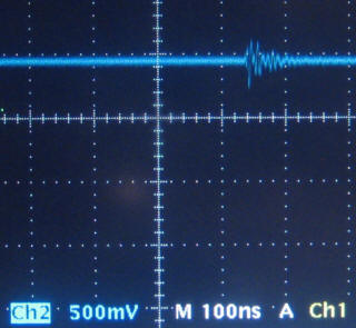

c) The only noise left over is the slight ring from the PIC's PWM signal (note the signal is completely flush either side. The time base on this test is 100nS)
img46-jpg.25613
