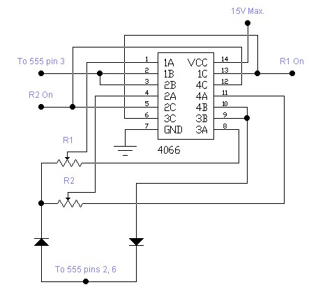

Here is a way to use one 555 with two selectable PWM duty cycles. It uses a 4066 analog switch to select either of two pots that control the duty cycle of a 555.
A logic high on the appropriate input selects that pot. The pot not selected must be at a logic low (0V).
(Note: The logic high must be equal to the supply voltage).
Note that the maximum 4066 supply voltage is 15V.

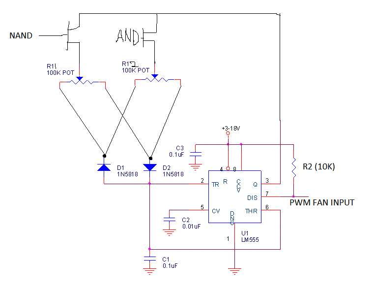

Regarding the above (and attached). Wouldnt changing the R1 pot (now R11 and R12 in my schematic) just change the frequency not the duty cycle?
The whole circuit is based on how fast the C1 resistor charges and discharges but its the same circuit so wouldnt the duty cycle be 50% all the time?
EDIT: Never mind the above i realized my mistake
Is there a suggested frequency to run this at?
Also is the below how you thought i would integrate the logic?

One question, this circuit is based on the fact that the output pin of a 555 timer can sink and source current but I dont see that mentioned in any of the data sheets im looking at, is it a typical 555 timer thing?
Also just to make sure, the output PWM signal is a pull high that is forced low (sinked) by the discharge pin right, just want to make sure i understand this properly.
The 555 timer can source or sink 200 mA. I should mention the standard 555 as in NE555 variety:

I would build the circuits using the values shown in the first link I posted. That should get you going. Just use 2 pots and run with that. I would do the switching exactly as crutschow mentions using a CD4066 quad bi lateral switch.
Ron
