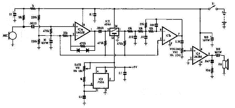

Just a quicky. On the picture attached I have added a variable resistor to
the mic input of the circuit(left). The supposed Idea is to be able to adjust the sensitivity of the electret mic. The main direction being to reduce the sensitivity. Is this a valid train of thought or the hopeless meanderings of
a hopeless novice?

You didn't attach a schematic.
The variable resistor needs to be an AC volume control without affecting the DC.
sorry about that heres the schematic.

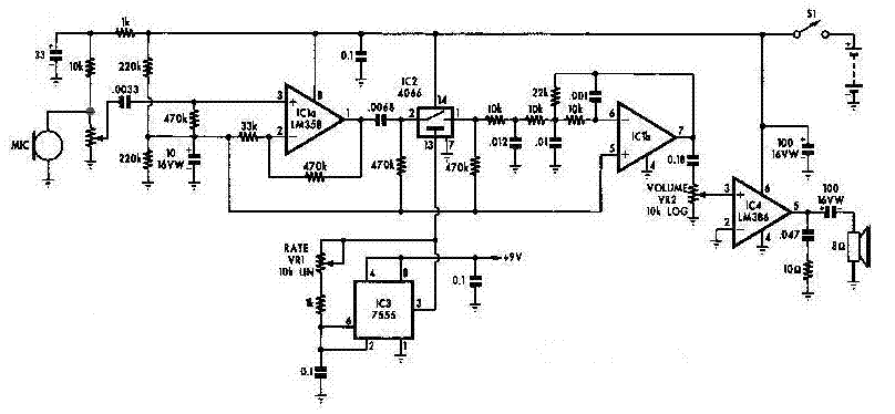

The pot at the mic affects its DC voltge and current. Then I think the mic will be very distorted.
Use a coupling capacitor from the mic to the top of the volume control. Then another coupling cap from the slider of the volume control to the input of the opamp.

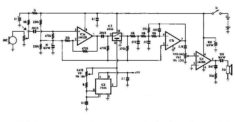

Here's the right way of doing it.

Hi Hero,
The pot now steals some of the current that is supposed to power the electret mic. With DC in the pot then it makes noise when it is adjusted.
Add a coupling capacitor between the mic and the top of the pot.
Another option would be to use the pot for the 10k current limiting resistor or just use a 100k pot so the amount of current stolen is negligible.
Yes but it's always best to not have dc in the pot if you can afford the cap.
and ele. mics get noisy if the dc limiting resistor is too large.
10k is already as big as you want.
(the source is not specified but my tests years ago were for 9 vdc)
"unusable"? I don't understand.
Hero999's second option having the 10k and 100k pot in series (mic at junction, cap at wiper) is not so bad.
It will make a loud crackling noise everytime you turn it, and as it's directly on the mike input it will be LOUD. NEVER feed DC through a volume pot.
It's feeding DC directly through the pot, it's terrible - feed the top of the pot via a capacitor, or (even better) do the volume control later on, or in the feedback loop of the opamp.

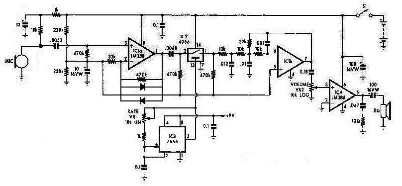

You could add two back-to-back diodes in the negative feedback loop of the 1st opamp to clamp loud external noises and add a buzzy distortion to a loud voice.

Would the feedback loop be where the 470K resistor is between pins 1 and 2?
Yes, connect two 1N4148 diodes back-to-back in parralel with the 470k resistor to clamp the output of this opamp to about 0.7V peak.
Hell Fire! I worked it out?!?!?! :D Thanks for the heads up I will experiment
with this idea. Thank you. So it would look like as in the picture attached?

No, maybe I should have said, "in parallel but with opposite polarities".
The diodes must be in parallel one with reversed polarity to the other. They are both in parallel with the 470k resistor.
