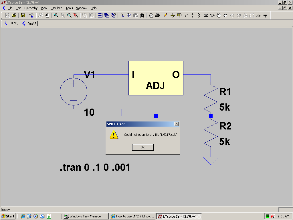

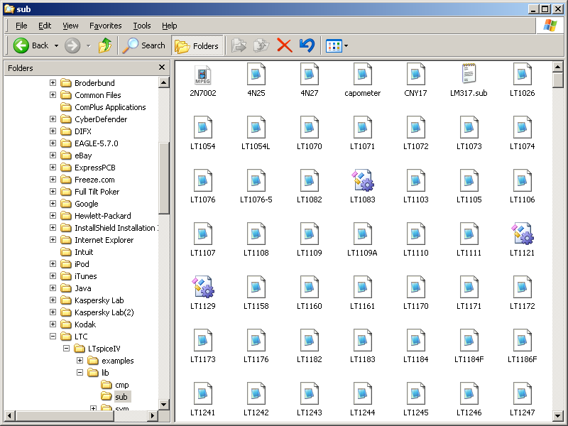

Sorry about the second post but I thought I should put the question in the right place. I am trying to add a 317 regulator to LTSpice. It is my first attempt and I can't get it to work. I copied the code from a post here and pasted into note pad. Saved the symbol into misc. and the model into sub as .asy and .sub. I can insert the part into a schematic but can't simulate. I think I must be doing something wrong with the file type or ????
For some reason I am having trouble opening zip files so I haven't tried other models.

Try to add .include LM317.sub to LTS diagram

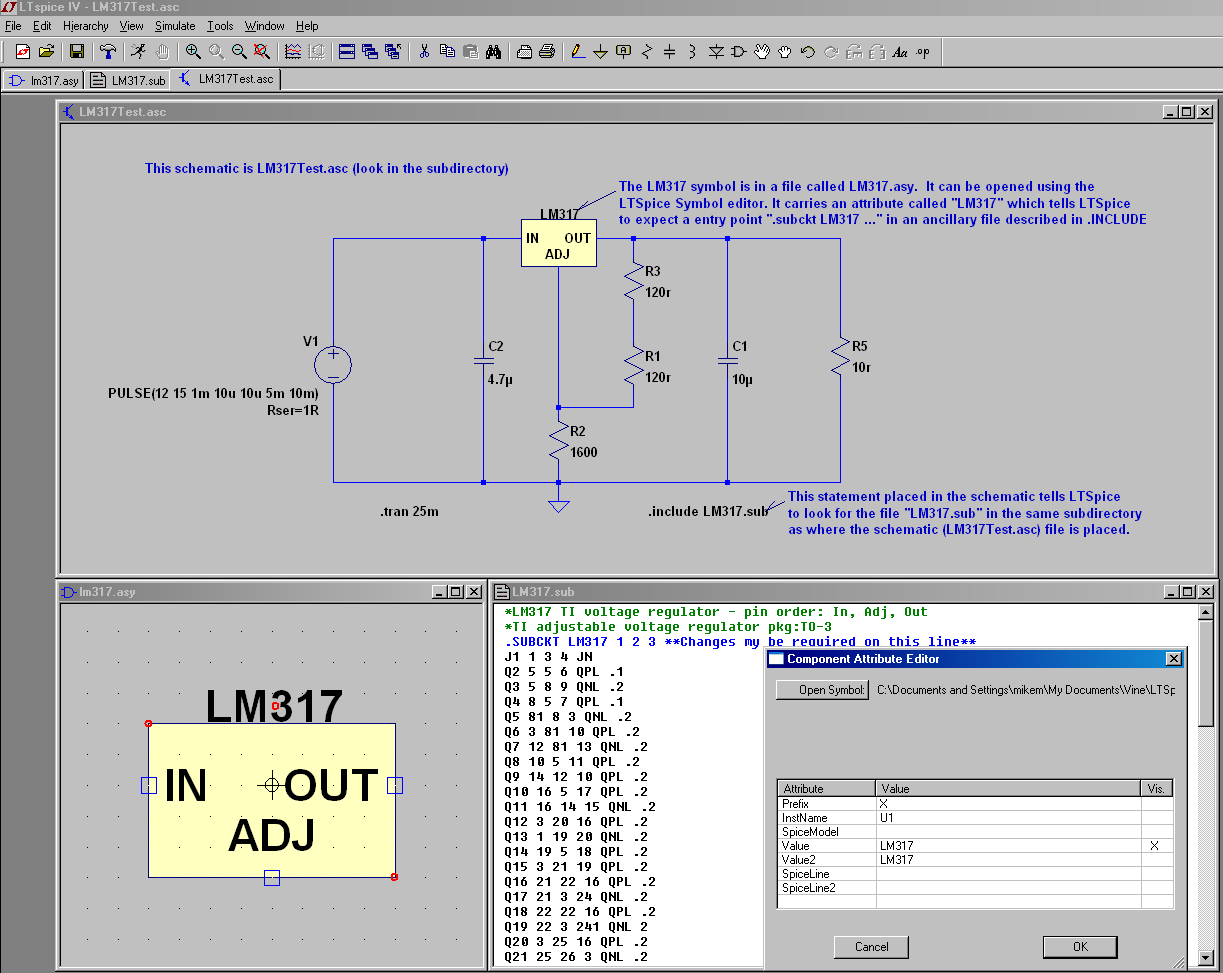

Here is Eric's example, changed around a bit. Since you cant UNZIP a file, I have included three attached files here. Save them to a clean subdirectory on your computer. You will have to rename two of them to get rid of the ".txt" suffix. This web site will not allow uploading of files with .sub or .asy suffix, so I had to use the work around of adding the .txt. You really should fix your ZIP installation because almost LTSpice models exist in .ZIP format.
The thumbnail is a screen shot showing all three files open inside LTSpice, and also includes an Attribute window which opens if you click on the LM317 symbol in the Schematic window.
The first attached file is an LTSPICE schematic:LM317Test.asc which includes an LM317 symbol. Provided the other two files are correctly placed in the same subdirectory, this will simulate.
The simulation subcircuit model of the LM317 is contained in the second attached file LM317.sub. This is a text file which can be opened using LTSpice's Text (or any other) editor. After saving this file in your subdirectory, rename it to get rid of the .txt
The graphics and attributes of the LM317 symbol is defined in the third file LM317.asy. It was created using the LTSpice symbol editor (similar but distinct from the Schematic editor). It can be opened and viewed inside the Symbol editor. After saving this file in your subdirectory, rename it to get rid of the .txt
If you successfully down load three files, and renamed two of them, you will have a running simulation which includes the LM317 and shows how well it regulates...

Can't thank you enough. I had a few hours in this. Seems there are several ways to do this but yours was very clean .(although I'm not sure I could do it again) I ended up (I think) making a file I called LM317. I then copied it into Misc. in Spice. I wasn't sure where to put it. I don't know what the deal is with my zip files. Neither computer could open any from this site but had no problem with other zips from other sites. The other download I had would never have worked as it didn't have the circuit file.
