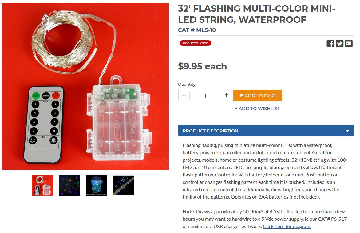

See picture of the circuit I am using. I know it has a timer, but would like to add photocell to turn off during daytime. Will have on my patio for summer parties.
Your lamp draws 50 to 80mA so about 25 hours of use.
Also, there is a remote control IR receiver of some Type so even putting the photo-cell circuit in series with the LED strand will not turn that off so, I'm not sure if the works is worth the benefit.
The black blob (COB), in the center of the green PCB at the top of the battery compartment, is most-likely the 'brains' behind the selection of the flashing/pulsing/fading, and IR remote control for the LED string.
If this device 'remembers' the last state it was in, when it was switched off, then continues to operate in that state, you may have some success.
alec_t's suggestion for a "dark-detector circuit" might be implemented, to cut/restore power supply to this device, and resume the last state.
