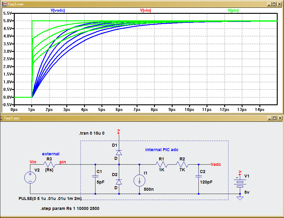

hi qt,
This is a LTspice I did recently, it models the PIC's adc input circuitry.
The plot shows the effect of the signal source impedance [ resistance ].
The idea for the cap at the adc pin is that a 'high' source resistance charges up the cap and when the PIC switches on the adc, the external cap quickly charges the PIC's internal cap, which is about 5pF/120pF.
Its important that the source resistance and cap values are chosen in order to give the best performance.

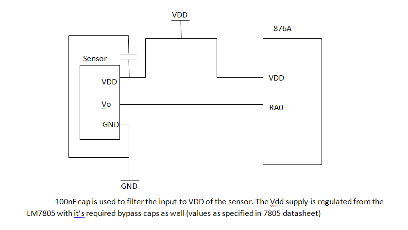

Post a wiring diagram which includes the sensor, its bypassing, the connection to the PIC, including how you are regulation the VDD (reference voltage for the ADC).

thank you for your reply mr.gibbs and for your simulation:). Im actually receiving from a SHARP Analogue IR Distance Sensor
im continuously sampling it actually but the sensor updates at 26Hz so i guess that's how frequent i need to sample the sensor. As for the resolution, I need to measure in 1cm intervals and the sensor maximum range goes up to 80cm.
Is there any reference/table/formula to which I can refer to employ the best combination?

hey mike.....sorry I didn;t see your post..attached is the wiring diagram:)

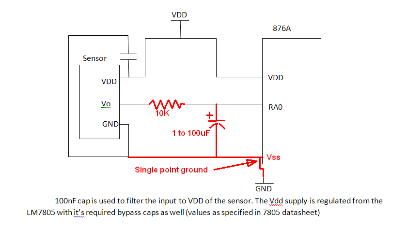

Also, try this:
The capacitor sets the low-pass filtering. I'm guessing a time-constant of about 0.1 to 0.5sec will help.
Make sure that the sensor ground is connected back to the PIC's Vss pin without touching other "grounds" along the way.

You don't hook that up that way you change the timing ..
Burt,
Bad link!
The whole idea of adding the RC filter is TO CHANGE THE TIMING!!! It is not called a low-pass filter for nothing. I suggest you read up on "ANTI-ALIAS Filters"
The sharp infra-red detector has a 1.2 k ohm resistance by add 10 k ohm your changing that to 11.2 k ohm that would change all your timing calculations
You'll be changing it out put to 446.429 Microamps how could that be good
Is a filter used before a signal sampler, to restrict the bandwidth of a signal to approximately satisfy the sampling theorem
It has that made in it and your adding one so how will that help.
Mike ML- I'm not saying your wrong What I don't get is why the OP would want to do this when you have a chart to show output for cm. Why not use that.
