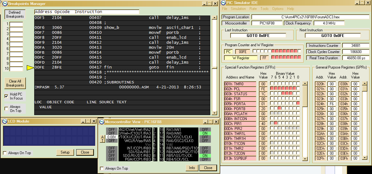

it seems that the AD result transfer segment is okay. may be something else is wrong. here is my code. porta is configured before this module. RA4 is the analog input.

I think would be more helpful if you posted your full code.
ok, here it is..

Note that port B should be written in the program as PORTB not portb otherwise the MPLAB assembler will not recognise it and throw up an error.
I cannot get your code to run using Oshonsoft.??
It also reports a missing delay_400us routine.
You could use this short program for testing your ADC and LCD it is written using the same pin out for the 16F88 as your program.
You can either program your 16F88 with the hex file or use MPLAB to assemble the ASM file.
I have included the Oshonsoft Basic program for reference.

hi
this piece of code will be very helpful. i am gonna try this and check where my code gone wrong.
by the way MPLAB simulator generate one message when i run this code which tells there is no stimulant file for ADRESL and ADRESH.
do you think i should try some other software tools for debugging? i will gladly accept suggestions and advices.
thanks
lipschutz

hi
the problem is solved i.e the program is behaving as desired i.e some analog voltage is input through pin RA4, the uC read this voltage and show its corresponding BCD vlaue on LCD. but this performance is obtained only after employing sufficient delays. i guess i may not understand the datasheet properly. here is two point to ponder.
the INTRC is set to 4MHz.
1. according to my understanding the ad clock frequencey Fosc/8 should be sufficient ref: page 118, datasheet 16F88. but doing so generate an error of Tad less than 1.6us. until i reduce it to Fosc/64 the message keep on showing.
2. after each nibble transfer an 1ms delay is employed. without this delay characters become garbled on the lcd screen. but according to the data sheet HD44780 it should handle each character within 1us.
there might be two reasons, first i mistakenly set the clock frequency to much higher value. second something mistakenly interpreted from data sheet. i enclose my code. please advice if you find some reason for this findings.

Your delays are too long also why is the 'fin' trap used, the program locks up!
look a this image.
I will run it again later today, let you know.
E.
hi
yes my delays are far too long, two reasons: first my problem is not time critical and it measures one sample at a time, basically it measures opacity of a paper strip.and this is why the program is locked to a point. i think the same thing could have been done without locking it to that line. a reset MCLR push switch will be implemented to get as many run as one wants. but do you suggest something that would be better?
Second i was desperate to see my program into work so used the subroutine of 1ms knowing that it would be sufficient anyway.
i could not figure out this point so far. also are there any way to know the internal clock frequency using oscilloscope i.e manually? i mean how could i be sure it is running on 4MHz? i am a bit skeptic about the oscillator frequency settings code resides at the begnning of the code.
thanks for your help
