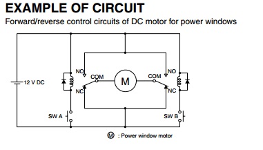

I have a actuator HK-DZT-03 that I am using to raise and lower a board. The actuator is shown in the following link.
The actuator is currently being driven from a relay (ACT512) which is switched via a ULN controlled via a PIC. The PIC also has a current sensing circuit which monitors the current draw from the actuator to determine if we have reached full travel when the limit switches are reached.
The problem that I am experiencing is that I am getting a massive spark across the relay contacts when the actuator stalls. I have tried to catch with firmware the increase current before the stall but it still happens every now and again. I am assuming it is counter EMF generated by the motor producing this spark.
I am thinking that I can either put a transorb or a varistor across the relay contacts to eleminate this counter EMF.
I have attached a basic example of the relay configuration.
How would I go about calculating the value I require? Are there set formulas to calculate this is is all hocus pocus?

So my read is you intentionally run the actuator motor into a stall? I did look at some data for the relay, since it is enclosed how do you see the contacts arcing? Not that it matters much. When the motor is driven into a stall how much current does it draw? I would guess a geared actuator motor driven to a stall draws quite a bit. Heck, the bit of data on the actuator beyond a 24 VDC motor makes no mention of current that I could find let alone stall or locked rotor current. There is a possibility that the current draw is exceeding the relay contact ratings. Do you know the stall current? Why drive the actuator to a stall?

Here are the relays you are using for switching the motor load:
N.O.: 20 A 14V DC, N.C.: 10 A 14V DC
That being for a resistive load. At 8 amps when those contacts open you are at 80% load on the contacts and again, for a resistive load which you do not have. I can understand the relay contacts being upset and likely having a short life, maybe weld themselves together which will really make a mess. You can try an RC Snubber type design across your motor terminals and see if that helps. However, I would be looking towards a relay or contactor with much higher rated contacts for your testing.

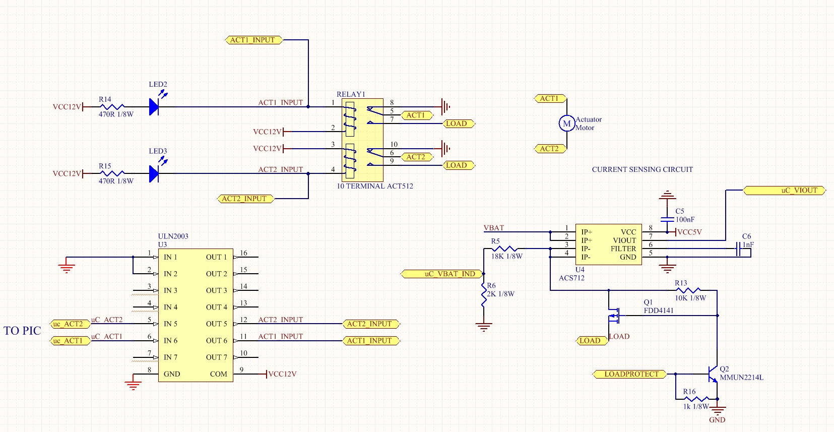

I have attached the schematic for both the actuator drive and the current sensing circuit. When stalled a spark is produced across the ACT1 /ACT2 terminals. I think that this occurs due to the fact that relay contacts are not entirely synchronized and that there is no where for the EMF from the actuator to go. I have dropped the maximum cut off current down from 8A to 6A and have noticed it is not as bad but still does occur.

Hopefully you use the limit switch to prevent end stop stall current which may be 5x operating current.
Imax is determined by ESR of motor and Vcc.
For in-between end-limit occasional stalls, one can use a PTC fuse value that does not limit normal load current. e.g. 2A just like power windows and windshield wiper motors.
You must have considered that each output of the ULN is rated max at 500mA and 300mA per driver.
A MOSFET with SCR overcurrent clamp would be better with dual Zener or bipolar MOV protection without uC intervention. Joule rating must >VI*tmax or >LI² of motor for stall current, I.
Relay contacts won't last long if they have to break stall current often.
A 10A bridge can also be used for bidirectional control with PWM soft limiter with 100uH coil and plastic film cap.
Use twisted pair wiring with ferrite CM choke for EMI control.
Relay spikes also create a lot of EMI , even with addition of flashover clamp.
ULN never got hot?
