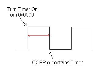

Hello,
You can use the CCP module to figure out the pulse width. It needs to be set to capture mode and the timer you choose to use along with it configured.
1. Make sure the timer is off and clear it. Set the CCP module to watch for a rising edge first. Clear the flag CCPxIF and then wait for it to be set again, signifying a rising edge.
2. Turn on the timer, set the CCP module to watch for a falling edge, and clear the CCPxIF flag. Wait for it to be set again, and a falling edge has been detected. CCPRxL and CCPRxH now contain the 16-bit value of timer when the event occurred, which is also equal to the pulse width between rising and falling edges.
Make sure to reset the CCPxIF flag and timer before you try to repeat this for another reading. You can also make a nice little loop using indirect addressing to store a series of readings sequentially in memory so you can average the result.
https://ww1.microchip.com/downloads/en/DeviceDoc/39605F.pdf
Check out Chapter 15 and more specifically 15.3 for capture mode.

i have not tried nothing yet just writing all suggestions .... Also at the moment i am trying to learn how to use this timer thing...
I know how to do the second half of that sentence but how do i do whats in BOLD Above?
Also just to make sure ...would i do like a BTFSS on CCP1IF ... and then jump to start if it is clear(0) and if set(1) then clear it and continue to look for falling edge?

Which Timer are you planning to use.?
You get the next high going edge which starts the timer
You get the next low going edge which stops the timer
The count in the timer is a function of PIC internal clock and the period for which the timer was counting.
You preload the counters and start the next pulse width timing.

So tell me if i get it so far:
Steps:
1. Setup CCP1CON for 0101 = Capture mode, every rising edge then
2. When it triggers it will start The Timer1/3 i have to clear CCP1IF then
3. Setup CCP1CON for 0100 = Capture mode, every falling edge then
4. It will stop the timer and i do something with results in timer?
Lets say you choose to use timer3. It is easier to start with an initial value of the timer at zero. So before you start:
              bcf    T3CON, TMR3ON
              clrf   TMR3L
              clrf   TMR3H                   ;timer3 cleared and off
              bcf    PIR1, CCP1IF            ;clear the flag
Loop1         btfss  PIR1, CCP1IF            ;wait for the rising edge
              goto   Loop1
              bsf    T3CON, TMR3ON           ;then start the timer
After that, you need to change CCP1CON to watch for a falling edge.
Loop2         btfss  PIR1, CCP1IF           ;wait for the falling edge
              goto   Loop2
              bcf    PIR1, CCP1IF
Now CCPR1L and CCPR1H contain the value of timer3 when the falling edge occured, giving you the pulse width. The actual time value will depend on the prescale selected for timer3 and crystal used.
-Jacob
Edit - The CCP module does not control the timer, it just captures its value when an event happens. You have to manually control it. Also, I could not find a link to the datasheet for the accelerometer, do you have one? I might be able to help more if I can see what the range of pulse widths the accelerometer outputs.
