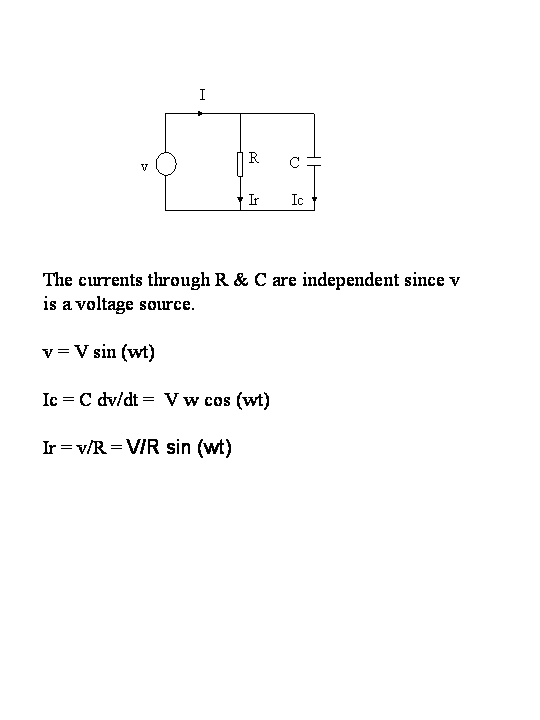

oh sorry abt that.but its just an R and L in parallel and an RC parallel to sinusoidal source.
Here is the steady state solution for the RC circuit.
Do you need the transient solution also?
I"ll do the RL one tomorrow.

Thankyou sooooooooo much Len,
I do know the steady state solution for RL and RC.. but i am stuck with the differential equations like the one we figured out before.

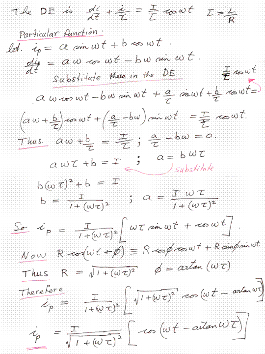

ok i think i have something cleared.
Ldi/dt=R(I-i)
Ldi/dt=R(Icosωt-i)
Ldi/dt+Ri=RIcoswt
now,
do i assume particular soluion as Acoswt..?this is assumed for first order equations?
then for the complementary solution
Ldi/dt+Ri=0
hmm...is the solution k exp(-t/tau)?
am i gettn somewhere? :D
Ldi/dt=R(I-i)
Ldi/dt=R(Icosωt-i) Divide both sides by L
di/dt+R/Li=RIcoswt/L
now,
Yes, A = I/tau e^(-t/tau) and integral e^(t/tau) coswt dt
di/dt+Ri/L=0 Yes
hmm...is the solution k exp(-t/tau)? yes; tau = L/R
am i gettn somewhere? Yes :D

"Yes, A = I/tau e^(-t/tau) and integral e^(t/tau) coswt dt "
hmm..?why and?
is this right?
1.integral[di/i}=integral(-R/L) dt
ln i= -R/Lt+K
i=exp(-t/tau+k)
i=exp(-t/tau).exp(k)
at t=0 depends om the initial conditions.
current throu inductor is zero....am i right?
2.how did u get that value for A?
let I the input be Icoswt.
for getting the particular solution from
assume
i=Acoswt
substituting in above eqn
-Lwsinwt+RAcoswt=RIcoswt
equating the 2 sides
RAcoswt=RIcoswt
which gives A
this looks absurd....don u think?
niga said:
is this right?
ln i - ln k= -R/Lt
i= k exp(-t/tau)
i= k exp(-t/tau)
current throu inductor is zero....am i right? Yes, but don't evaluate k at this point. Wait until you find the particular function and then i = ic + ip where c = complementry, p = particular
Then make i = 0 and t = 0 to determine k
2.how did u get that value for A? I think you may be misunderstanding what I meant by "A"
The particular function is ip = I/tau exp (-t/tau) integral exp(t/tau) cos wt dt where tau = L/R

is that the particular solution for all first order equations?
then why do we assume A=I coswt?
looks like am a very difficult student! :wink:
i read that Acoswt is the solution assumed for first and second order equations.
and its found by putting into the first equation and equating the coefficients on RHS and LHS....is it correct?
but then the value of A; ip = I/tau exp (-t/tau) integral exp(t/tau) cos wt dt where tau = L/R
when i equated the two sides i din get this...sheesh i think i am a dumbo. :lol:
if i may just ask
i tot this is wat we wud get
ln i=-R/Lt+k
how does it become ln k?
ln i - ln k= -R/Lt
i= k exp(-t/tau)
i= k exp(-t/tau
Taking your last question first, if k is a constant, then ln k is also a constant.
It is better expressed as: ln i = -Rt/L + C, let C = ln k
Thus ln i - ln k = -Rt/L
so ln (i/k) = -Rt/L
and hence i = k exp (-Rt/L) = k exp (-t/tau)
I have done the Particular Function part of the problem in the attachment.
This is the general solution for finding the particular function for cases where the right hand side is cos and/or sin.
If the the RHS was expotential, then the PF would be expotential.
If the the RHS was ax^2 + b x + c then the PF would be of this form.
Re your second question, The method I used is a short cut.
Note that in the attachment, it is R cos (wt - phi); the "-" looks like a "+".
Len
