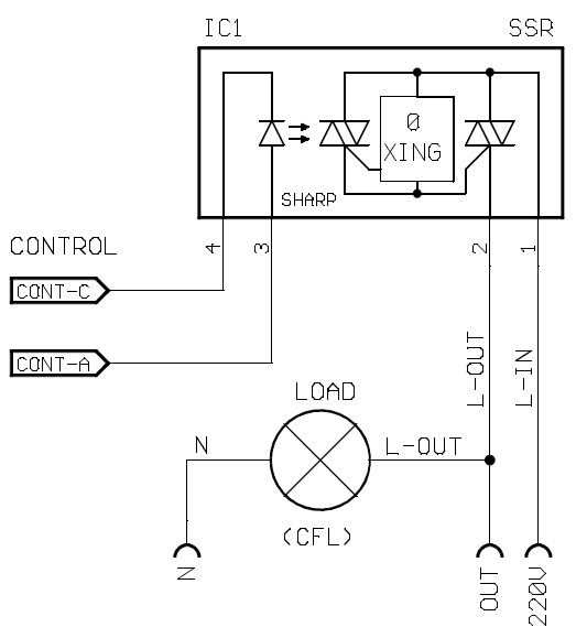

I am putting together an AC SSR, I need it to poeer a 120VAC red indicator neon lamp.
The input is a 9v battery, the ssr kit is rated input of 5-15vDC and output of up to 220VAC 4 amps.
These are some pics of the kit all soldered together. How do I connect the 120VAC lamp to the output? I tried connecting it directly to the two holes, but it did not light up. Any help?

Take a look at Figure 3. You don't need 220VAC. That's the maximum nominal voltage you "can" use with this kit. Your neon pilot will replace the light bulb in Figure 3. The power cord for 120VAC is wired exactly the same as shown.

Hi shake_zula,
before you can get mains out of the circuit you must put it in.
Connect mains (life) to the solder pad labeled 220V and connect one terminal of the CFL to OUT. Connect the other terminal of the CFL to mains (neutral).
Please follow the sketch.
Boncuk

You will need a load across the triac. Like a 25 watt lamp. It will not work with just a neon indicator. Andy

I have a ABS box for this but heres a pic of the circuit let me know if this is the proper connection.
That looks like the right connection (although again, hard to tell with such crappy pictures).
What people are trying to tell you here is that this may not work at all because your little neon lamp is not a big enough load for the triac. So if this doesn't work, try it with a standard incandescent light bulb to see if that works. If it does, then you're going to have to find another way to control your neon lamp.
Neon bulbs consume very, very little current.
The neon bulb stay off until i instert the 9volt battery, it then lights up bright, but only dims when the 9volt is removed. Now it stay on even when i plus it in with the 9volt. Will it matter if I add another 120VAC neon light? what about a capacitor??
