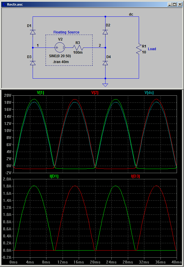

I recently realized that I don't really understand rectification of AC voltage, or is it current?
So an AC sine wave is basically alternating in amplitude between positive and negative as referenced to Zer0 volts. It's either positive or negative but never both at the same time. But in full bridge rectification it is explained that one side is positive while the other is negative at the same time then they switch polarity with positive being negative and negative being positive and we end up having one side positive at every half cycle. That doesn't make sense to me because a sine wave has only on "hump" at a time, either positive or negative.

Think of a bridge as steering diodes that direct each negative going and positive going pulse to a particular output path so the polarity result is constant for each.

Look at this sim. Your confusion comes from where the ground symbol is placed. To get a "full-wave rectified" voltage with a DC component across the Load, the ground (0V reference) is placed at the bottom end of the load resistance. That requires that the AC voltage source (transformer winding) be "floating", i.e. must be isolated from Gnd. This allows the diodes to steer the current from the source so that it always flows only in one direction (top to bottom) in the load resistance.
Note that the voltages at the V(1) and V(2) go negative by one diode drop. This is because neither node 1 or node 2 are connected to Gnd.
This is why connecting rectifiers directly to the AC line should never be done by newbies...
