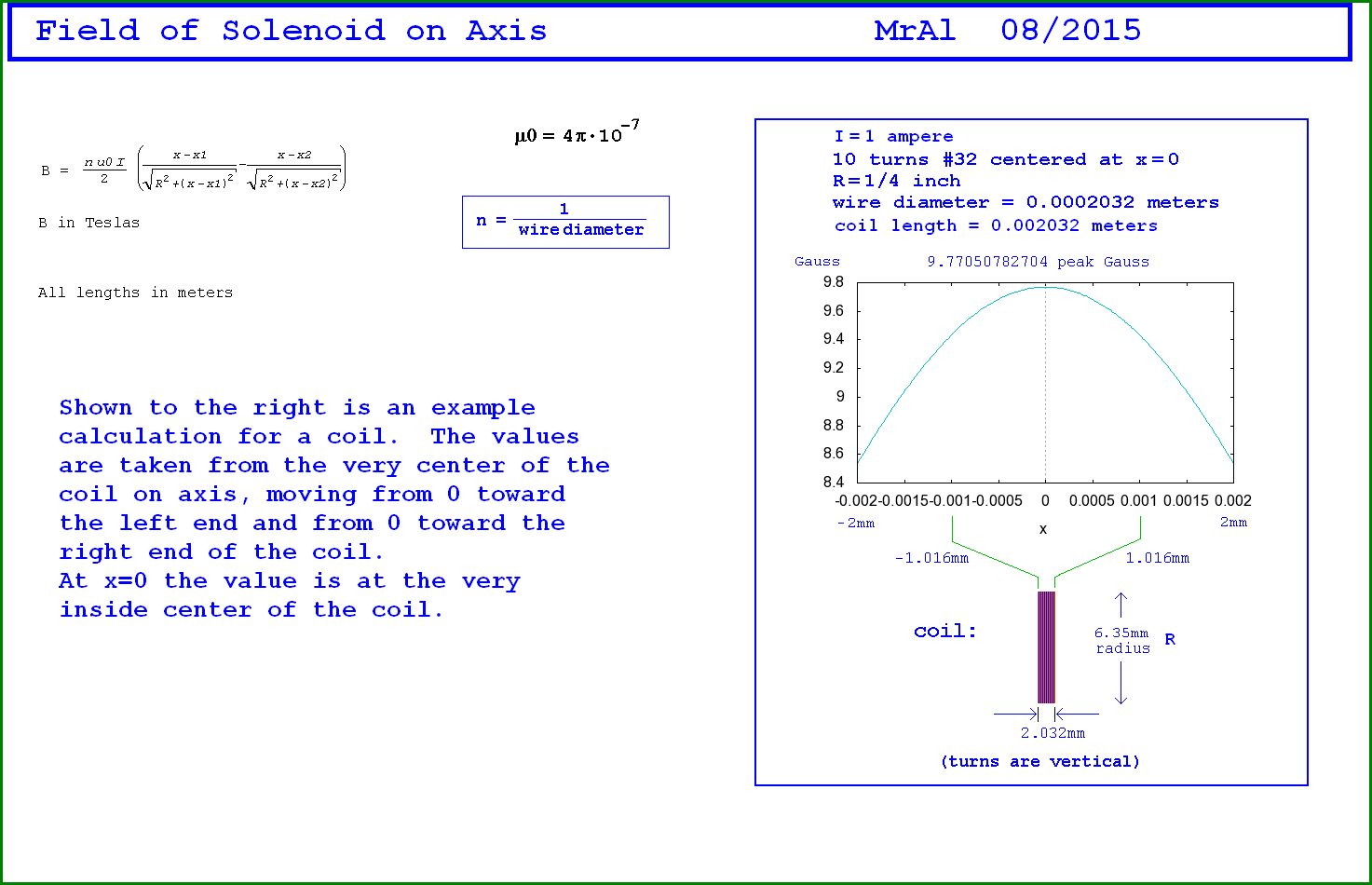

I would like to measure the magnetic field strength within a solenoid which has a current oscillating at around 100kHz.
In theory I could use a smaller coil with a resistor between the terminals and then measure the waveform voltage with a scope.
Does anyone know the calculations necessary to convert that information into a magnetic field measurement?
I'm assuming it will not be totally straightforward as I would need to consider the number of turns, area of pickup coil, induced voltage/current and the frequency.
Any pointers would be appreciated!

I'm looking for something fairly precise so that I can compare the field strengths in induction heater coils.

It would not be easy to place a small coil inside another one and get the position just right. As you can see from the graph in the attachment, the field varies as you move along the axis, but it will also vary along the cross section so this makes it difficult. If you do place a coil inside, it would probably be best to find a way to calibrate it anyway so you know you are getting true reading values.
The attachment shows how to calculate the field inside the coil along the axis which we call 'x' here. If you want the field at the very center, set x=0.
x1 is the left side end position, x2 is the right side end position, as measure from the center of the coil. This means the length of the coil is L=x2-x1, and so x1=-L/2 and x2=L/2.

Putting a coil inside is tricky too, because it's not a spherical detector. To get the actual field readings you'd have to be able to sense the direction of the field also. Otherwise you have to assume it is oriented parallel to the coil length directly in the center. As you move toward one end, the direction will change, first slightly then more until it reaches 90 degrees from axis, then more until it points back the other way on the outside of the coil.
We could do some calculations to show the field and direction of an ideal coil, but there are probably pics on the web. Also, this will be for an ideal coil and we have no idea if your coil is near ideal or not (ideal with respect to the geometry, not with respect to the electrical characteristics). It is probably close though.
It would probably be simpler just to measure the center of the coil, along the axis, but if you move outside the coil rotate the coil in a plane parallel to say a vertical slice along the length. Rotate the coil back and forth until you get the highest reading, keeping the very center of the coil at a constant distance from the center of the large coil.
There should be no reason why you cant get relative readings this way. There wont be any base calibration to go by, but if you see a reading of 2 and then somewhere else a reading of 1, you know the field decreased probably by a factor of 2.
Inside and outside you should be able to keep the coil parallel to the big coil, as long as you dont get too close to the ends. The field should be symmetrical about a circular path around the coil diameter.
