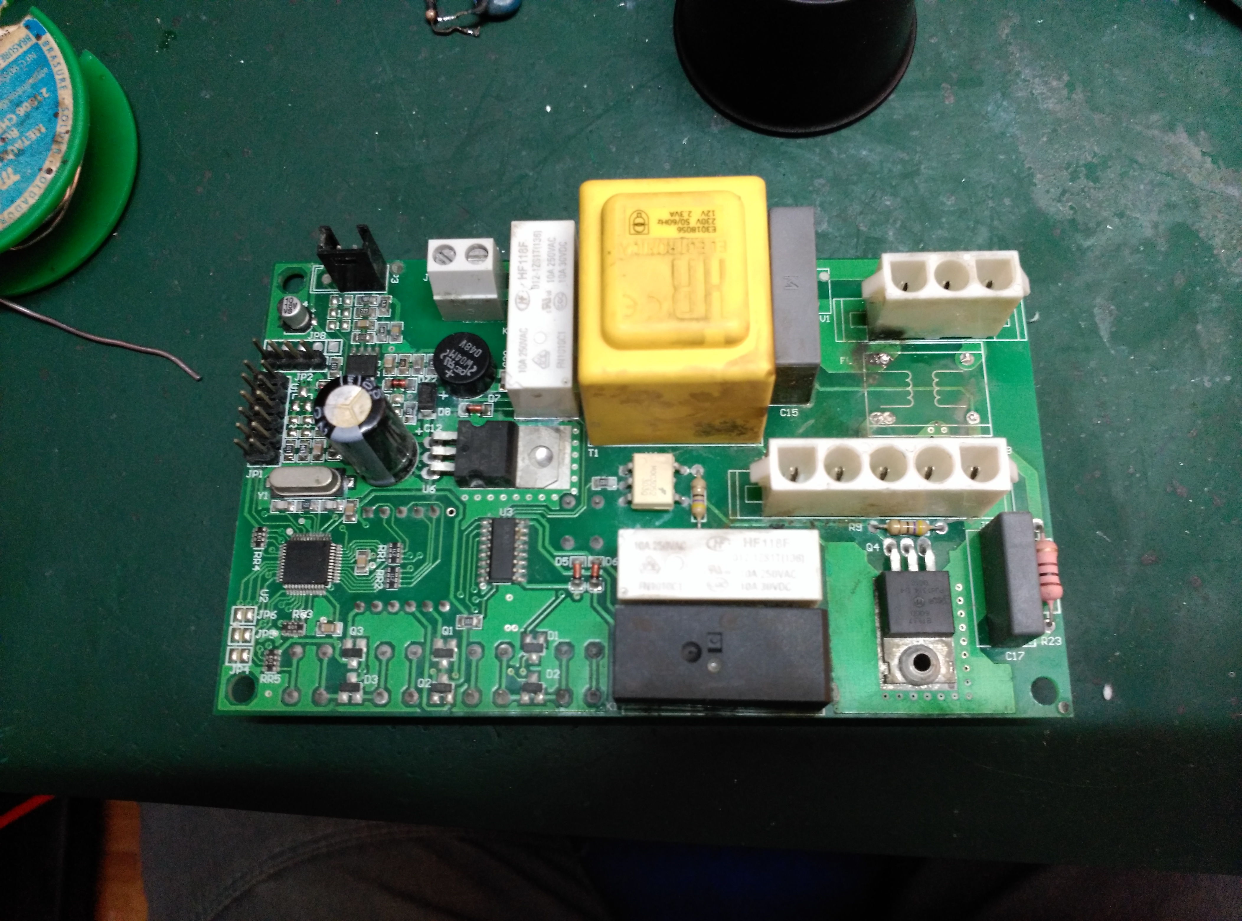

I have an Ektron board from an industrial washing machine. I see it has a triac damaged and also the 220Vac input filter, 2 coils burnt and capacitors too. Capacitors are 2n2 400X1 250Y2 and inductors I don´t know which value they were.

Hi guys,

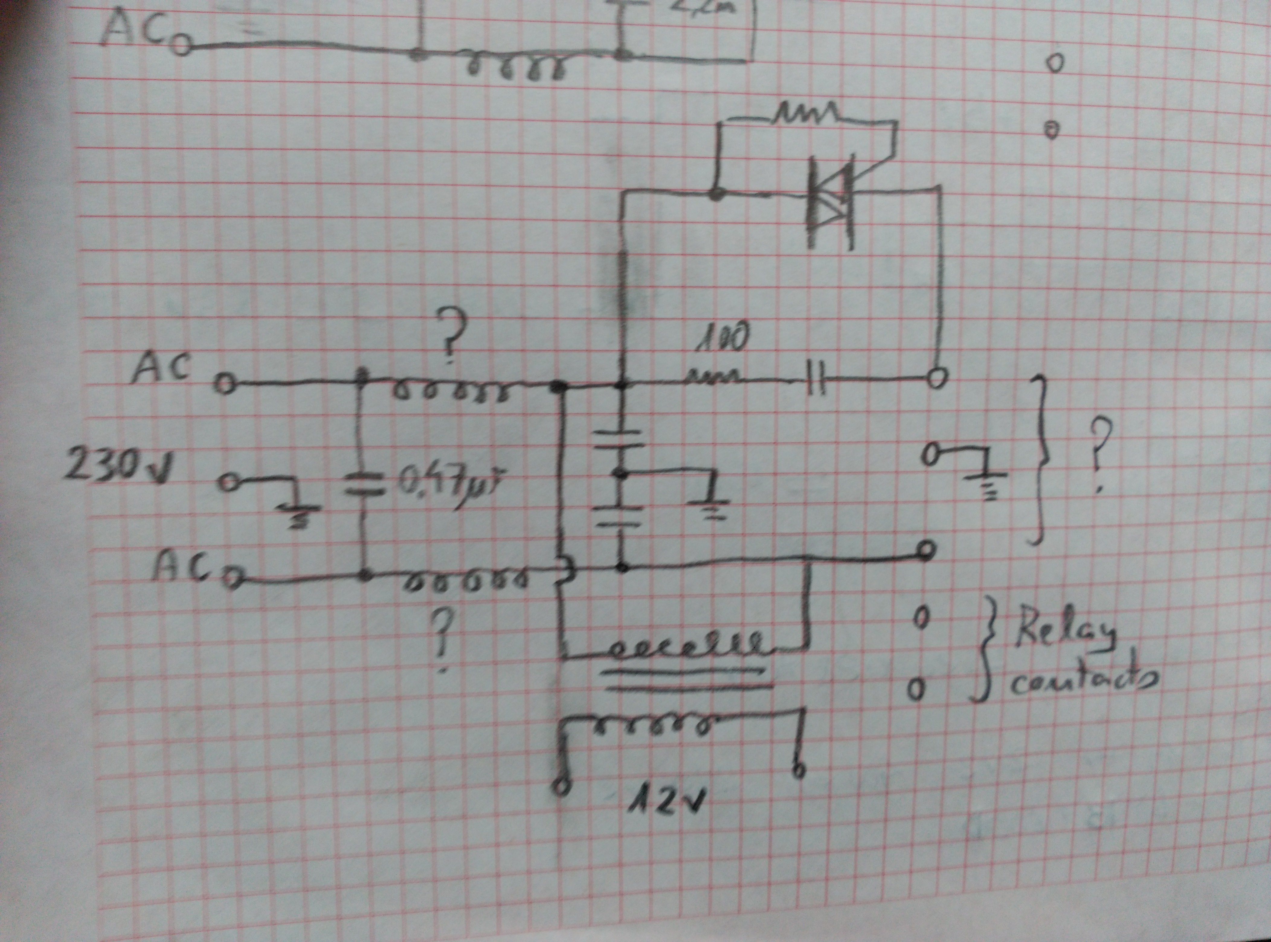

I put some pictures and the schematic:
http://www.restoretronic.com/descargas/Ektron/esquema.jpg
http://www.restoretronic.com/descargas/Ektron/Inductancia.jpg
http://www.restoretronic.com/descargas/Ektron/1.jpg

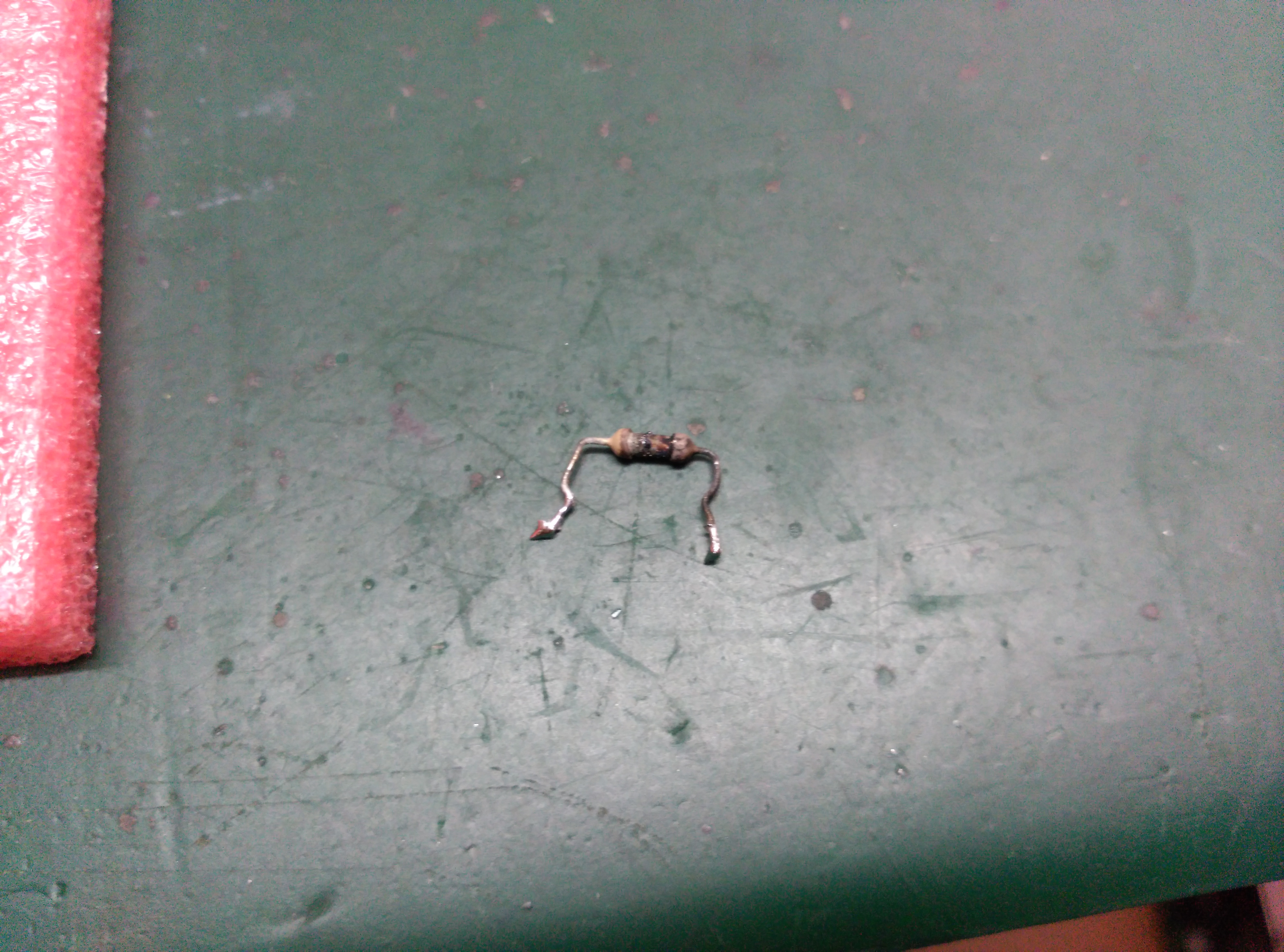

3 pin connector is the Vac input. 5 pin connector is the Vac output, 2 last are going to relays so not important as the problem was coming or from the load or from overvoltage.
As you see the inductor seems a resistor... The parallel capacitors are 2,2nF and the serial one 0,1 uF. I don´t have information about what is behind 5 pin connector, they only gave the board. What to you think about the inductors?
Thats interesting, kind of.
When I looked at the schem I thought thats a differential choke, then when I saw the photo of the pcb I was alsmost certain it was, but then you show us 2 inductors that look like resistors.
Its almost as though the manufacturers intended to fit a differential choke then didnt they fitted individual inductors.
A diffrential inductor (theres probably other names too) is a coile with 2 windings, usually in opposite driections, so that high frequency noise on one line gets cancelled by the same noise on the other linea due to the opposing windings.
They will probably be low values esp looking at the size of them as they will need to handle at least a few ma.
Will the manufacturers tell you what they are, well these days they probably dont know it'll be outsourced, could you look at another one that still works and get the colour codes?
The circuit woudl probably still work with them linked out, however that wouldnt be good practice as noise from the triac circuit which can be bad would be transmitted through the mains wiring.
You know dr pepper, I would say know may be somebody fitted there a resistors instead of its original noise filter because as you can see at the picture they seem resistors. Usually when they are inductors the components body colour is green.
I didn't contact to the manufacturer, under my experience it's wasting time, they are italian. I couldn't find any info at Internet to find the original value.
I think I will put a choke from another 220v filter board or just jump them to try it informing my customer about that solution.
The triac is for 8A.
My sentiments too.
And thats just what i would do, I just didnt want to say it in case you did it and got into trouble on my advise.
