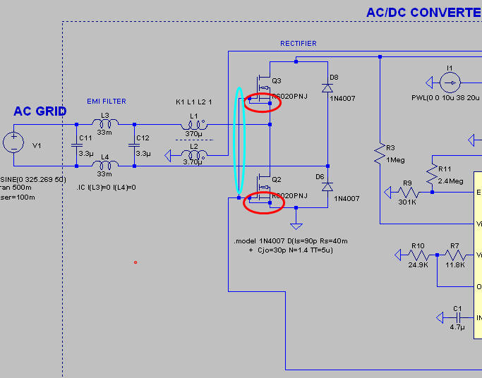

I used the LT8312 PFC controller to controlling the switches, but somehow the switches seems not to operating in the bridge, only the diodes.
Do anyone know what could be the problem why the switches do not operate?

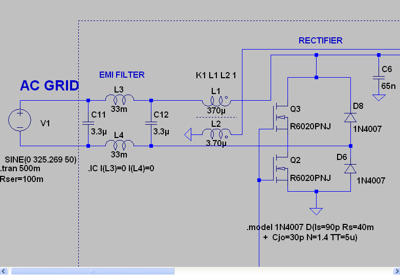

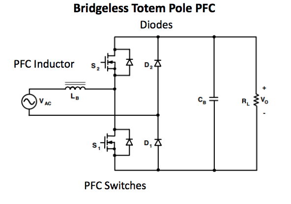

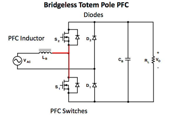

I did used the demo for LT8312 in this circuit, I just modified to make a totem-pole, where there are two switches connected. Like this I have attached.

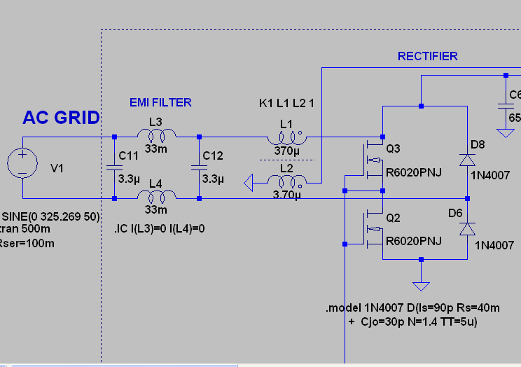

I saw one misstake in my circuit now, I have connected the AC side wrong to the bridge, I have adjusted it now.

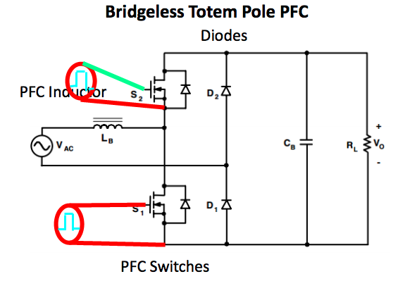

The all MOSFETs are turned on with a voltage from G to S, NOT from Gate to ground.
The source of S2 is not at ground. It can not be controlled by an IC that is sitting on ground.
And you never made this circuit.
And this is not "interleaved".
Post #4 circuit 2. Q3 shorted G-S. Q2 shorted G-D.
Post #4 circuit 2 & 3. What is in red below is not in circuit 2 & 3. You have the right side of Lb connected to S2 Drain.
Red circle. Q3 gate shorted to ground. Q2 gate shorted shorted to ground.
Blue circle. You can not drive Q3 gate directly from the IC.
Okay, I see. But how can I create an voltage over the gate and source for Q2 and Q3 with the IC? By adding a voltage source as we did for the switches for the DC/DC converter?
You say that I can't drive Q3 gate directly from the IC, where should the gate of Q3 be connected to in that case? I am not sure..
Probably one of the most used parts to drive "high side MOSFETs" is the IRS2004.
It is built to drive both high and low side FETs.

In SPICE use a voltage controlled voltage source to get isolation.
This you tube is slow and hard to hear but try it.
Here is a VCVS. In this case the voltage on the inputs is goes through a formula then to the output.
Vin X 50 = Vout
In your case change 50 to 1.
The output of a IC can connect to the input of the VCVS. (also ground)
The MOSFET (that is not on ground ) connect Gate to (+) and Source to (-).
The right hand GND could be anything, because there is isolation inside the VCVS.

The idea is to take the bottom MOSFET gate signal and invert it. So I set the gain of E1 to -1. The (-) inverts the signal.
I could not find a way to subtract 13 volts from the signal so I set E1 on a 13V voltage source.
If you plat GTDR and compare to Q3GATE-Q3SOURCE you will see that any time Q2 is on Q1 is not on.
Your circuit is not working. I don't know what it should do.
I just fixed the top MOSFET gate drive problem.

I know but its not working. Maybe the two Gate signals are not right. Where did you get this idea? They should give you information on when the top switch should be on and when the bottom switch should be on. It is easy to say "here is a circuit" and "magic drives the two switches". Many books show a circuit + magic. (never been tried)
I got this idea cause it is using less components, thus the charger could possibly be smaller.
https://www.kivi.nl/uploads/media/59565ab464588/Guido-Schott.pdf
I think the duty cycle should be 0.19 according to my calculations, but how can that be implemented in the circuit?
Its says according to this source that I have used: "D is the duty ratio of the active switch (Q1 or Q2) of the fast switching leg."
https://unitedsic.com/wp-content/uploads/2017/06/Totem-Pole-PFC-v2-AppNote-2017-06-23.pdf
Driving the top MOSFET adds a 8-pin IC and parts.
I do like the idea of not having fast diodes. (using a MOSFET as a fast diode) I do not see how it is smaller.
This only shows a thought. It does not show how to do it. I think Guido Schott never built one. He does not know how.
The duty cycle changes. Line voltage 0/360V/0/-360/0........ The duty cycle changes with the line voltage. I think "0.19" is at +360V or -360V. At 50V the duty cycle is different.
----edited----
You must not allow both MOSFETS to be on at the same time. (more parts)
