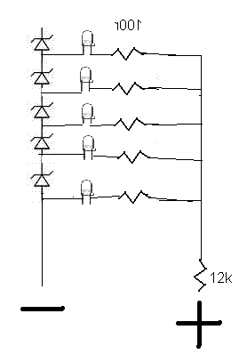

U user1453 New Member Aug 18, 2006 #1 I'm about to build a variable voltage power supply I don't always ont to be grabbing for the multimeter whenever I want to adjust the voltage to roughly something so I though of a simple (not very accurate) circuit the voltage range will be 0-24v my question do you think it would work? Attachments voltage indicator.GIF 4 KB · Views: 239

K kchriste New Member Forum Supporter Aug 18, 2006 #2 It'll work. I am assuming those are LEDs and not light bulbs. The low voltage indicators would end up much brighter than the higher voltage indicators as the voltage is increased. Have you thought about using an LM3914?

J john1 Active Member Aug 18, 2006 #4 You could just put a pencil mark by the control knob at various voltages. John
eblc1388 Active Member Aug 18, 2006 #5 john1 said: You could just put a pencil mark by the control knob at various voltages. John Click to expand... Second that. Been using the same for years without any problem. Difficulty is how to get the scale fairly linear for 0-24V so any adjustment is easy.
