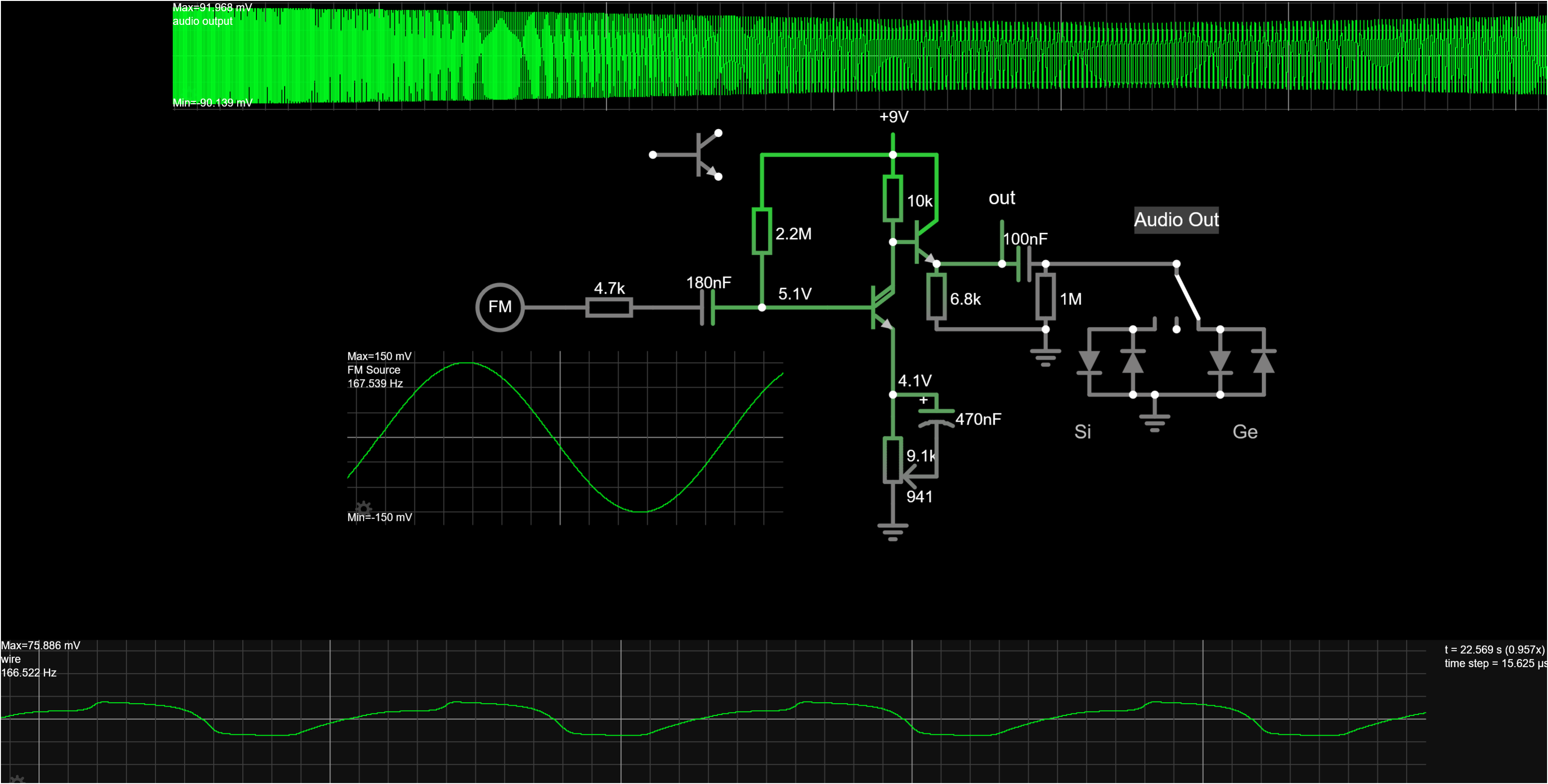

What do you expect from this? No input range specs? Impedance?
It's a soft limiter with low gain. I put in a 3-way switch and some extra distortion with a Darlington and added a buffer.
The audio play is only a 1 second max clip and you can play / repeat or change anything such as Collector resistor for more clipping on the bottom with more gain. Click the switch to rotate left.
This version creates 2nd harmonic transistor distortion and some others, odd harmonic diode distortion and is a soft limiter.
A sine wave is not as good a source as a guitar string.

Thanks for that info and the simulation, I appreciate it. I was looking for a subtle distortion. The circuit turned out to sound great in that respect.
I just use a guitar and amp to determine the sound, then experiment with different capacitors and clipping diodes. The germanium diodes sound great, very smooth type of distortion.
I will experiment with the mods you describe, very much appreciated.
