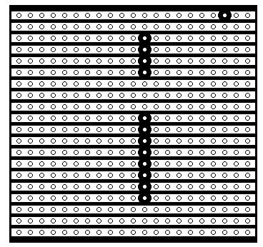

I am new to this chat and would like a helping hand from the experienced to help me out understand the what X CUT TRACK means in the circuit attached. I tried to connect the circuit exactly as it is wired but it didnt seem to work properly. All lights were on at the same time instead of functioning each one on its own to fulfill the purpose it is built for , as a traffic lights controlling circuit.

It's fairly self explanatory, it means to cut the copper track on the veroboard where each X is shown - it's easiest to use the proper track cutting tool, but a small twist drill can be used. The copper tracks are running horizontally by the way.

but i have no copper tracks in the place where the X sign is shown , that was the reason made me wonder what it meant , most especially when i made sure that I had connected the whole circuitery corectly, there were no good results. the circuits didnt work as it is supposed to. okay . I want now to ask about wether the direction of the capacitors on the right side of the bored is not right , because I cant recognise which side is the + and which is the -. what do you think

As Nigel points out, the copper tracks on stripboard should be running left to right (or right to left) and your components are placed vertically. Look at the 555 and 4017....you can see that if you do not cut any of the tracks between the pins, you will have both sides of each IC connected together.
To stop both sides from being connected together, you must break (cut) the copper track at point X. The same applies for the potentiometer.
If your board has no copper, or has solder pads around each hole, you must connect each component lead on the same horizontal line, except where there is an X.

and you will see that tracks have to be cut at the blue dots (same as X=cut track)

If the traces are running east-west, then the cap is oriented and connected properly to the 22KO resistor.

Hi Muhammad89, if you have the correct type of stripboard, then if you flip it over from left to right, you should have the track cuts as shown. You can use a small drill if you do not have the correct hand tool. Just be careful to count the holes (pitches) correctly before cutting. I have made so many mistakes in the past that I always double check before committing the cut :)
