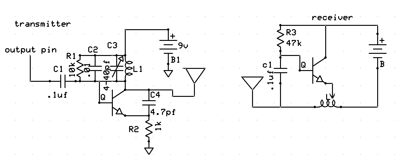

need a cheap short range transmitter receiver using a PIC as trigger to transmit a signal 75ft in a closed room. Just need to trigger an LED on/off by wireless from one transmitter to 12 receivers.
A simple 1 transistor circuit might work but thinking an output pin could be used as an oscillator to an antenna?
some schematics I found on web. maybe too simplistic?
NO voice communication, just a trigger pulse from transmitter to te 12 receivers that indicate a signal has been transmitted.

Good luck getting 75' with that set up! With that receiver, you may be lucky to get 7.5"
come on
this is too local for you
you are talking about 8 outputs
this one will kill your time and effort
look for something better that is digita.

As Mike stated, not a chance...
The Nordic modules are designed for use within the ISM band for very short range use, so not a chance of reliable 75' radius.
Look for something along the lines of RF Solutions FM Modules.
Normally I would say two tin cans and a bit of wet string, however 75' reliably to a dozen receivers is just out of range ;)

In my experience 2.4Ghz blows badly for distance compared to 900Mhz and 433Mhz, especially indoors.
RFM12B/RFM12BP if you want something digital. Otherwise, I hate those bit twiddle modules, but they would work fine in this case. Nigel has some tutorials on them. You'll need proper encoding.
Well it will be interesting to see what distance the 2.4ghz, w/chip antenna, Nordic modules can muster up.
I didn't say they won't hit the 75' mark, they may well do so, merely that I doubt that you will achieve reliablility at that range. Those particular Nordic modules are designed for use with wireless keyboards and mice which is very short range. The Microchip devices may also hit 75' as stated by wannaBinventor, however I have no practical experience of using them and therefore can't comment on their suitability for your application.
