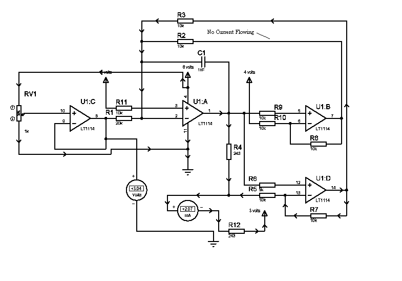

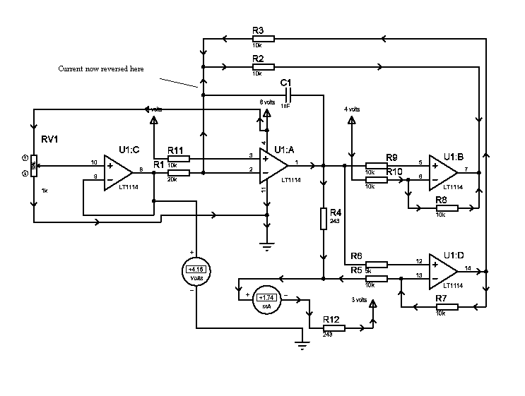

Hi... You all know I'm a software guy... I know enough electronics to do my job but on a recent repair to an older system I had an issue with the current convertor.... Its basically a simple op-amp voltage to current convertor, but with added circiuts.
The designer ( The old retired director of my old firm ) seems to have used up a quad op-amp package..
The input voltage is 3 to 4 volts... the output current measures 1.5mA to 2.5mA respectively
My question is what is the purpose of the feedback loops... Is one an over current, this is what it appears to be....
The job in question had fried R4.... instead of 243Ω we measured 6.7K... I'm trying to evaluate the issue so I can find out how it happened.
I hope someone can explain the circuit a bit better.

Hi, hmm if R4 was failed high ohms that is not a good sign, it means R4 was exposed to a sustained over-wattage situation (too much current through it). That excess current can only come through the IC via the output drivers in U1A, so it's very likely the IC is toast. I would replace the IC with R4.
Re the operation, there's one basic feedback mechanism; if the voltage drop across R4 is not high enough then the output of U1A is changed in voltage. The reason there are two branches in the feedback loop is because neither end of R4 is at a known fixed voltage, so the feedback measures 2 points to get the voltage between the 2 points, which then produces one feedback signal.
One of the analogue experts can probably explain the operation better than me but that's the basics of it.
Cheers Roman... I already swapped out the op-amp as this is what I thought it was.... I think as you do, the chip was damaged aswell.... I think someone had placed 24 volts ( the crane voltage ) on to the top of R4.... The problem has been solved... However this was the reason behind the post.... If that wasn't the case, and the overcurrent detection circuit ( if that is what it is ) has obviously failed to do its job....
The crane sits on a dock in Lancaster and are prey to high powered RF communication, ship to shore! I'm hoping that this wasn't to do with EMF....

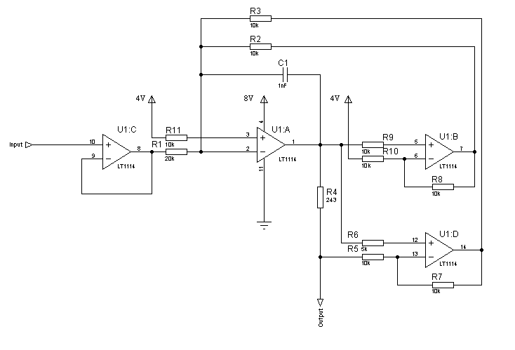

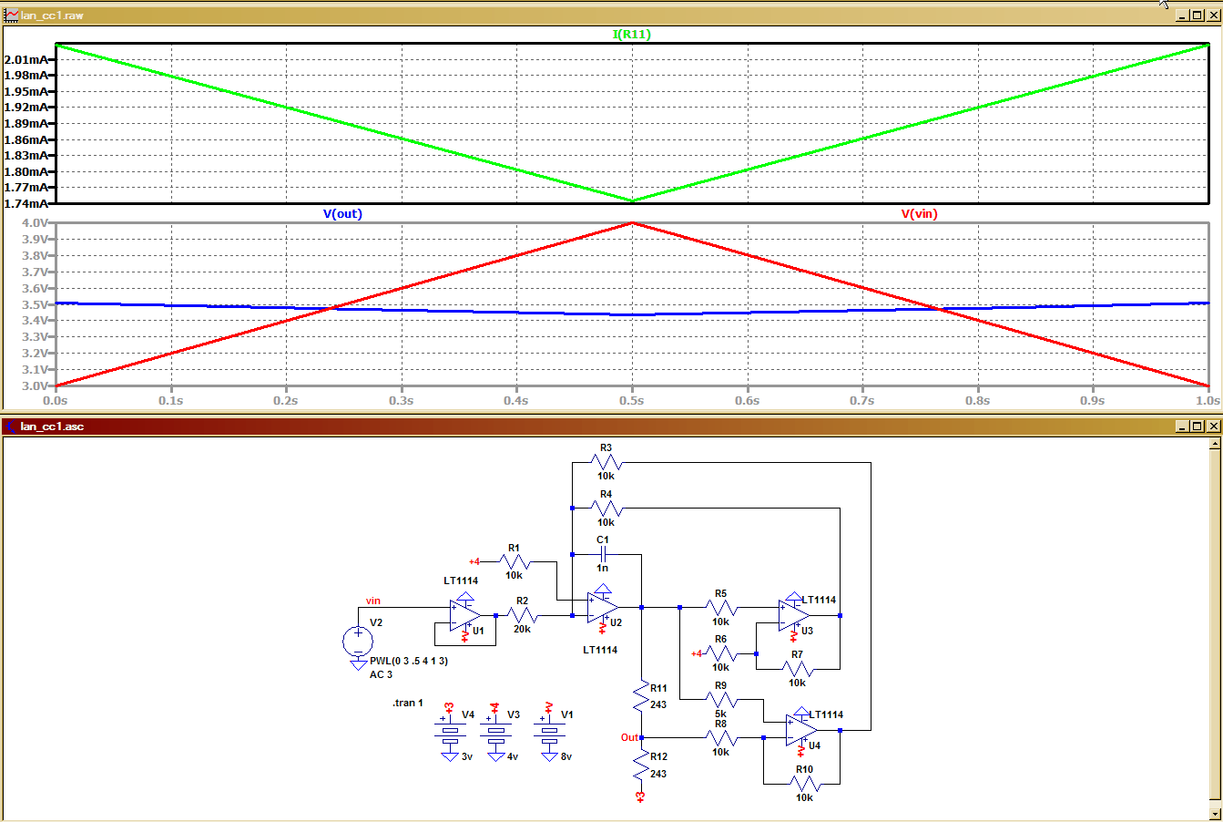

hi Ian,
Can you confirm the circuit diagram is correct.?
This what LTSpice shows in simulation.??
Also is the input range limited to 3Vdc thru 4Vdc
Eric
EDIT:
What load is the 243R driving into?

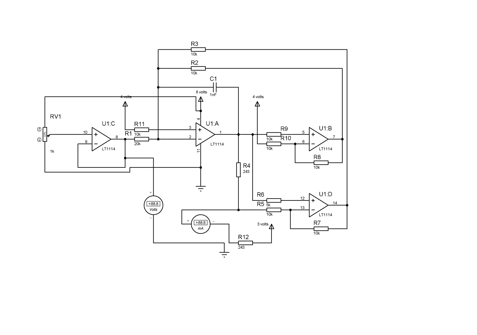

Hi Eric!! Yes! its a little unconventional but The output doesn't go to earth.... The guy who designed it has a hell of a lot more knowledge than I can ever have.
The output goes via another 243Ω resistor to 3v...
Here's the circuit under test on ISIS..

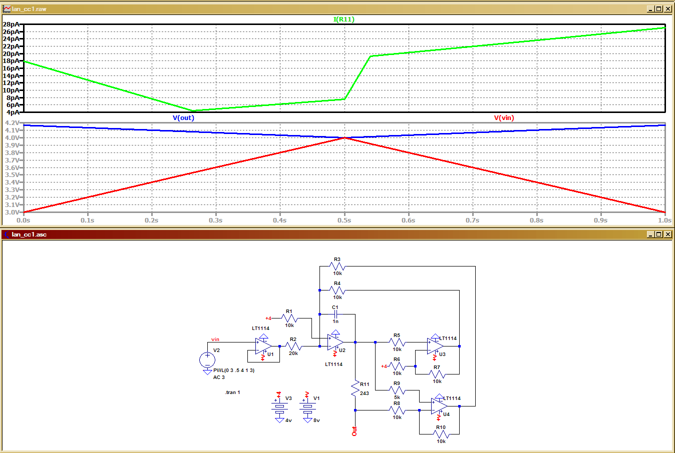

hiIan,
It looks like a Voltage to Current converter.
I used a Vdc input of +3V thru +4V then down to +3V
E.
EDIT:
I would agree that somehow a high voltage as been connected on the junction of the two 243R's
Using a internal 8V and 243R thats only 0.25W, not enough internally to burn the resistor.

Yes... I just needed to know the feeback loop.... I have never seen one like it since.

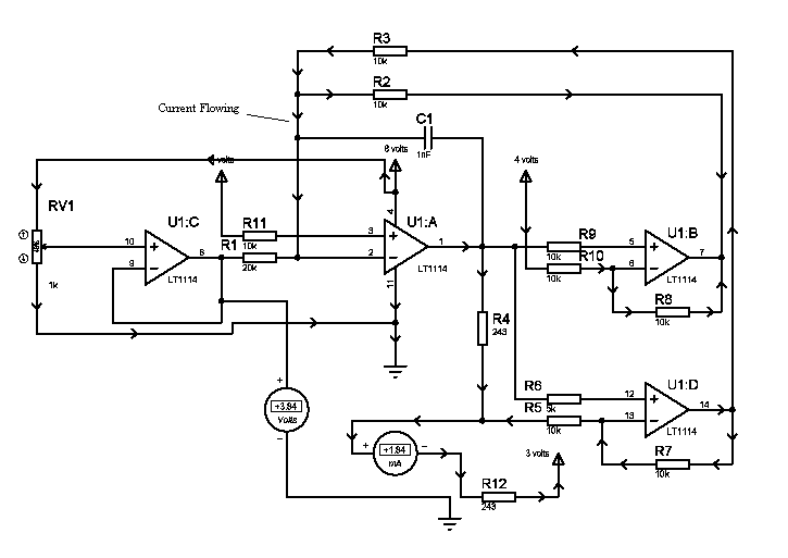

Here is the current flow for 3-4 volts, 4+ and 3- !
First 3.8 volts ( normal operation ) ..
Then above 4 volts... ( outside limits )..

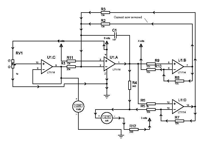

Then approaching 3 volts...
Finally.. below 3 volts ( outside limits )..
Like I said in the first place... I know its a voltage / current converter... I didn't understand the circuit fully..
