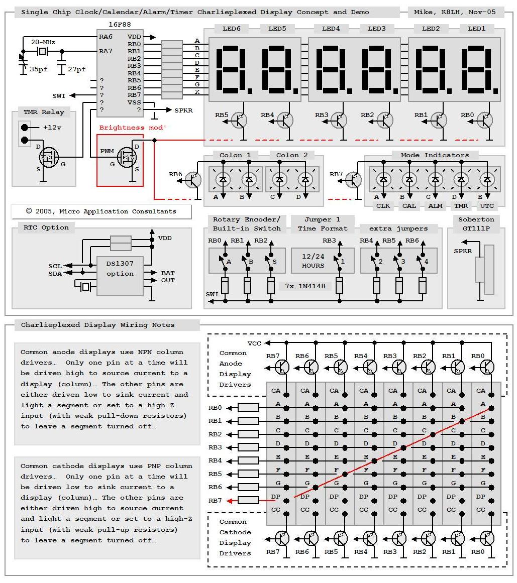

Hey Bill,
Your 1-chip Zebra design looks pretty nice... I'm happy to see someone trying/testing the Charlieplexing multiplexing scheme... May I pass along some tips from my experiments this last year?
<1> Use "active low" or "active high" column driver transistors for Common Cathode or Common Anode displays, respectively, for better display brightness... This allows sinking much more than the 25-ma I/O pin current limit on those columns...
<2> Use 10 to 47 ohm segment current limit resistors when driving more than 4 digits (LED duty cycles less than 25%) for better brightness... Again, the 20/25-ma I/O pin current limit is limiting our brightness... At 14% duty cycles those LED segments would actually like to be pulsed at 40 to 80 ma...
<3> I found Common Anode displays to be brighter than Common Cathode displays because the segment driver pins will sink 25-ma to the cathode segments on CA displays compared to sourcing 20-ma to the anode segments on CC displays...
Have fun... Kind regards, Mike

Great post Mike, I like your schematics. Especially the PWM brightness.
In an effort to keep the current levels (and heat) low I've driven the displays sans transistors and no dp. I love the look of LED vs LCD and find the HE red plenty bright now only if I could dim the little 3mm LEDs a little (I know I could use more resistors but simplicity is key)
It was your previous PICList article on Charlieplexing that I picked apart after looking at the Maxim data sheets.
Let me say thanks for your great article on the old PICLIST forums.
Question: Average current 20ma on a PIC Pin, do you know if 80ma at 25% duty is ok for a PIC? (Did you ever see that Super Probe at Mondo Technology? **broken link removed** ) He drives the display directly.

Hi Bill,
The PIC I/O pin structure keeps us from getting more than that 20/25-ma spec' (bummer)... So you have multiple segment driver pins that want to source 20-ma but your column driver pin limits their cumulative current to 25-ma... Column driver transistors allow us to sink the cumulative segment driver currents (up to 8 segments at 20-ma each = 160-ma)... By the way, with the built-in current limiting of the I/O pin you can pretty much eliminate the segment current limiting resistors alltogether (with 4 or more displays)...
The Agilent or Fairchild low current displays (3-5 ma/segment) work extremely well with Charlieplexing, even without column driver transistors...
Yes, I've seen the Super Probe... A 'nifty' design...
That PWM brightness control doesn't work as well as I had hoped... It seems the unconventional use of NPN or PNP transistors to maintain the "active low" or "active high" signals Charlieplexing requires prevented me from fading the displays completely to black because the displays see the base-emitter current... Using two transistors for each column driver would fix the problem but throwing parts at the problem seemed kinda' silly when you can just add another chip and have a standard multiplexed display with incredible brightness and full "fade-to-black" brightness control for each column while using the same 8-pin interface (see the version 2 clock below)...
Take care... Have fun... Kind regards, Mike
