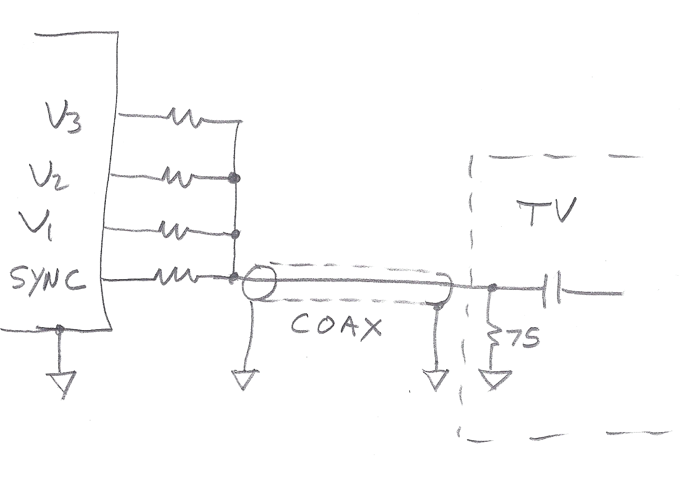

Hi Ron. I can explain what made it work. I built the circuit "from my head" without schematics just to get a feel for it. I had the idea about how to do it by using counters and logic to select which lines are horizontal sync and which lines are vertical sync. I did this without schematics so I have no schematics to offer. When I do have them because I will remake the circuit now that it works, then I will post them. So my signals were all sync signals, and what I wanted to do, and what created the issue was that I wanted the screen to go completely black after the sync signals. I wanted to do this simply to be able to see that the TV was indeed synchonizing to my signals. I wanted a way to make it black by tinkering it, and then making it white again, to see whether the TV would respond. If that worked, then I could be sure it was all working.
But my TV would display white no matter what voltage levels I would send to it after the sync, because the voltage I was sending was constant between each synch. So whether the voltage was zero or 1V or 4.5V wouldn't matter. It was always white! This drove me nuts because all materials on the web told me that if I varied the voltage between 0.3V and 1V, the shade would change. They also said that the reference voltage was black after synch. So by logic my tv should be black to start with. It was always white.
After I attached a cap to the output, my output was differentiated, with spikes after and before each synch. What was the output on the TV ??? It was a peak of white on the left, and then it went black on the right. That was the big clue. It must have been that the TV was taking the first voltage after synch as white rather than black, and because all my voltages were constant after synch, the tv would always be white.
So I made a counter to change the voltage after the synch multiple times, and indeed the TV started to show different shades. It had worked.
The solution was simple, the problem was that I didn't want to change the voltages until I could see the tv going black, and that was the problem because it simply wouldn't!
It was only after your post that I finally decided to try and change the voltages. So it's all thanks to you. Now the next step will be to make an interface so that this can comunicate with my second project, an 8bit computer also using 74HC IC's. Which is almost ready in fact!
