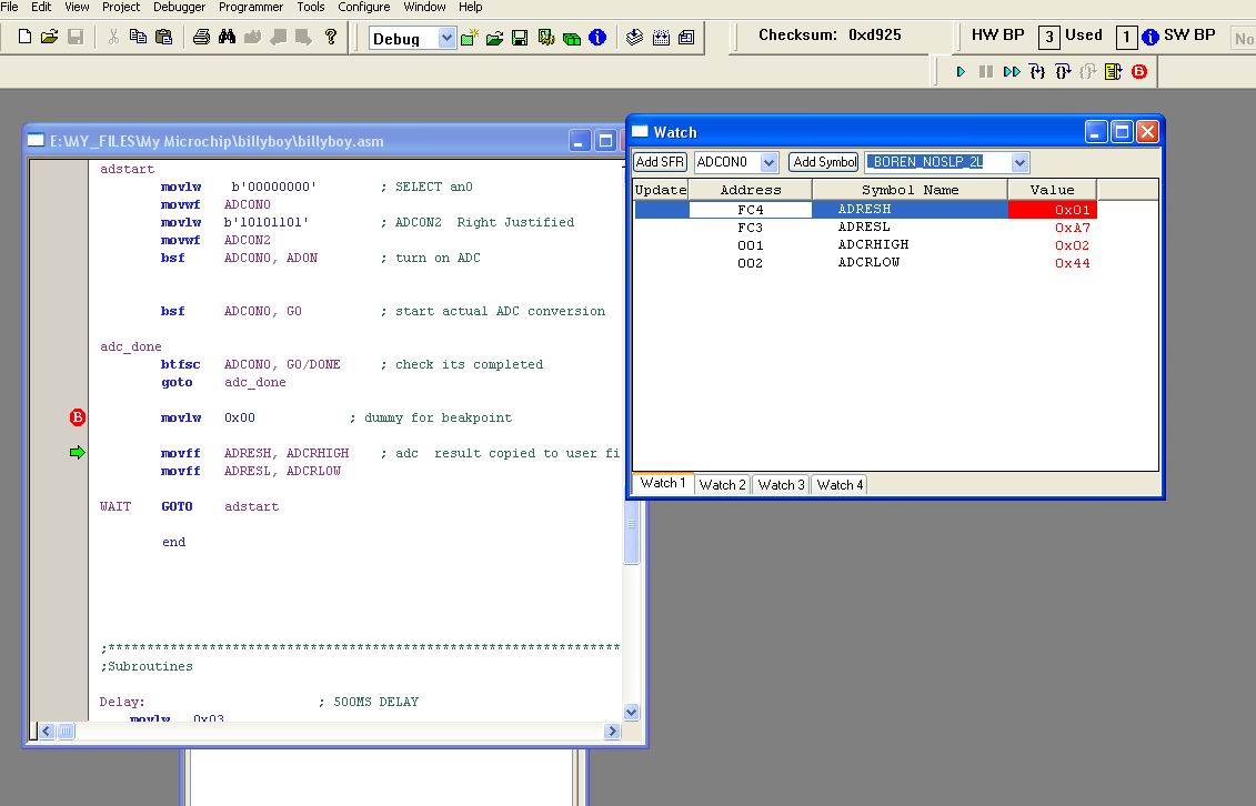

Norlin thanks opr answer, I think you forget to place some details ...
work with MPLAB and the programming language is in asm.
XTAL =48MHZ
and I read the datasheet and had already made a code but it is not correct, have you help me a bit ..... thanks in advance.

this is the program compiles fine on me but it's badly MPLAB,
I hope you help me ..... I have some time with this, perhaps I'm wrong ...

Try this code, its taken from my working program.
Have only built it, but it should run ok on hardware or Sims - use a 10k pot / trimmer as your adc input for your basic tests. so you can check the voltage with a dvm and then see if your adc result agrees with the voltage measured.

WP100've tested and reviewed your code and I have produced nothing, not that I'm making the mistake your code is similar to mine, I think qeu use similar settings ADCON records ...
well I'm using a 10K potentiometer, with its ends connected to 5V and ground and pin an0 average, I've also seen you use the 4MHz internal oscillator so the pic is only made with LEDs and the cable connecting the an0 pin to pin of potentiometer means ......
or did I miss something? please tell me
and also wanted to ask if you've tried? normal work for you? seriously help me a favor ...

Just got your message, will give it a try on the actual hardware - give me a hour ...
Well have just run the code I sent on the hardware via the Pickit2 Debugger and it works fine.
You can see it working on the screenshot.
In the 'watch' window you can see the adc result from the first adc reading has been transfered to the two user registers, I allowed it to do another reading but after a moved the 10k pot to a new posisition.
ADRESL and H now show the new value.
( with debugger you can stop and start the program as you like so you can see whats happening)
I have added onto the original code so that when it has done the adc routine it flashes a led on and off for 1 second on RB0, then it loops around to the adc again.
If your hardware is set up correctly it should seem to act as a simple led flasher.
I have run this code directly on the chip, not via the debugger, so you should get the same results if your hardware is ok.
Does it do that for you ? - if not send your actual assembler code back with a diagram of how your hardware is connected.
On the 4620 pins 32 and 11 should be VDD + and pins 31 and 12 VSS -.
