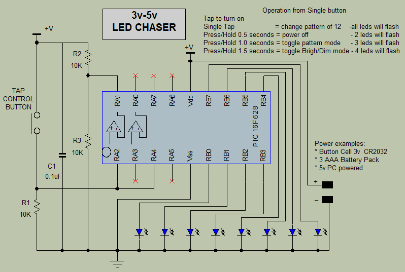

Hi Andy1845c it’s possible with a single PIC.
But for the rotary switch you mentioned its wasting another more PIC pins. If you are using PIC16f628A the maximum LEDs will be 8.bcuz other remaining pins used to the rotary switch (8+8).
It’s easy if you use a single switch to change your patterns. Using the external interrupt pin is very usefull in this case to place your switch.

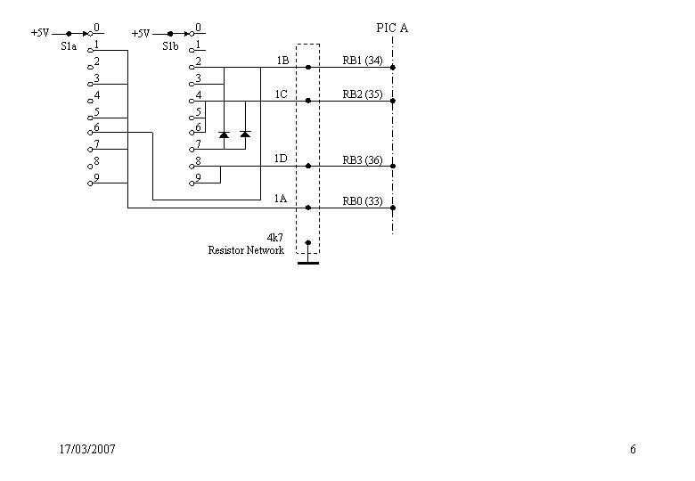

3. I want to select from 4-6 led patterns with a rotary switch. Is this possible/advisable with a single PIC? I assume I could use 4-6 seperate PICs, one for each pattern, but I am guessing thats not needed. Does anyone have a schematic or link to a similar project so I can get an idea on how this is done?
The trick is to convert from 1 of n to binary.
The attachment is an extract for one of my designs. I've converted 1 of 10 to binary using a 2 gang rotary switch.
It could be done with a one gang switch by:-
  1. using more diodes, or
  2. using a Priority Encoder IC.
In the case of a one gang, 4 position switch (ie. n = 4 ), all you need is 2 diodes and 2 resistors.
But if you use a 4 position, 2 gang switch, all you need is 2 resistors.
EDIT, I mis-read your request. You want 6 LED patterns.
So you can do it with a 2 gang 6 position switch and 3 resistors as per the 0 ~ 5 positions in the attachment,

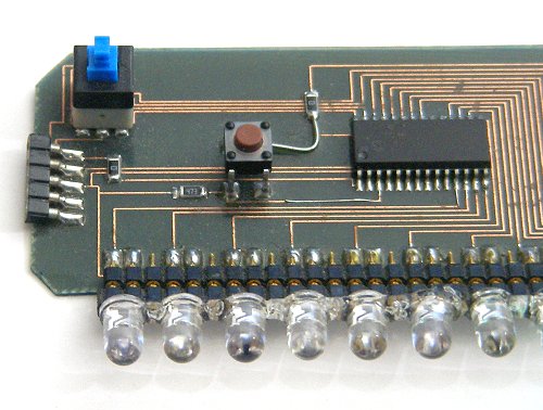

Gayan Soyza said:
donniedj I like your PCB.Are you using the tonner tranfer method or silk screen method.
Photolithograpic method with printed on transparency sheets.
