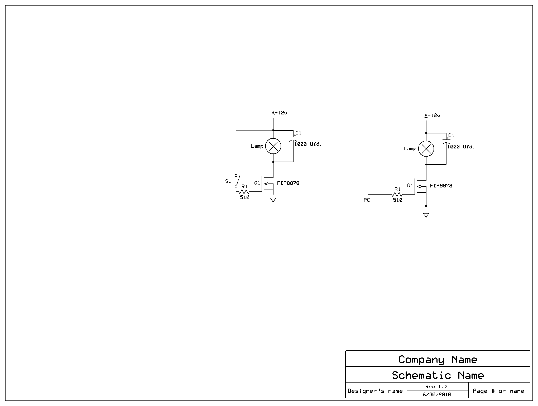

We wanted it to be controlled by another lower voltage circuit because we wish to have the whole thing controlled by a computer one day. Anyway - if we do use the same 12(v) circuit, I was told to use NPN transistors, which I don't really understand.
I was given this diagram:
Do you think it would work if I have the same setup on every bulb? and is the only thing I need is to connect the new switch (left to the power source) from a point above it to the other setups to have them all controlled by that same switch?

Yes, But that should be ok because your 12 volt supply has a transformer. But maybe I should ask you what that circuit looks like.
