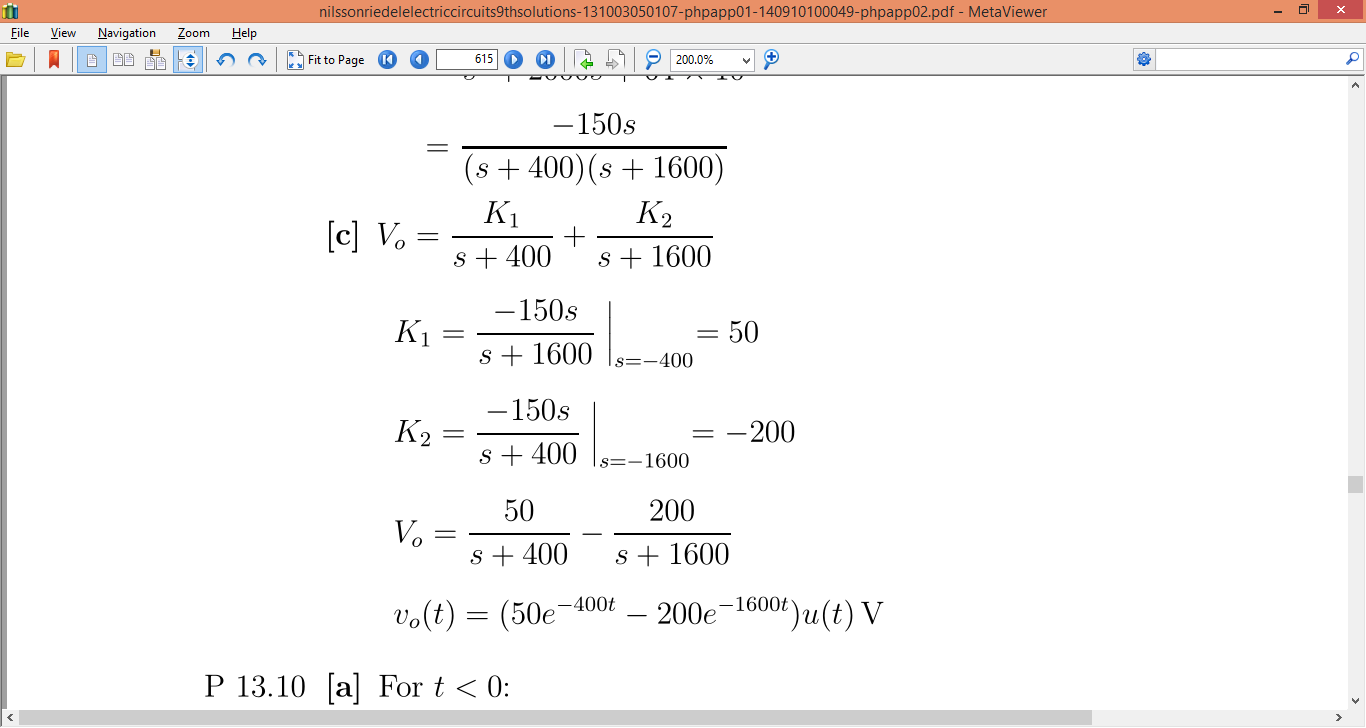

Hello,
Can anyone please solve the problem in the screenshot? This is a question from the book Electric circuits(9th edition) by James W nilsson and Susan Riedel.
Thank You.

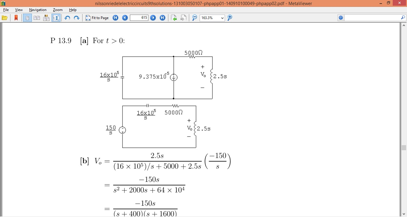

Yes the first one is the part a and b answers and the second is part c
View attachment 95630 View attachment 95631
OK, the solution is derived below. Ask if you have any questions. I expected the voltage to oscillate as the energy from the capacitor and the coil transferred energy back and forth, but it appears that 5000 ohms of resistance is enough to dampen any oscillations. You can see the oscillations if you lower the resistance to 2000 ohms.

First I'd like to show why we construct the s-domain circuit like that in the second diagram in post #6:
We can treat the first constant term as a voltage source, the second the voltage drop across the capacitor, the third across the resistor and the fourth across the inductor, so the equation itself indicates a kind of Kirchhoff's voltage law, and we build the s-domain circuit from it.
Next we can solve for I from the last equation in terms of s and the capacitor's initial voltage, then Vo is simply equal to IsL.
Once we have Vo in the s-domain, we can change it back to the corresponding time domain solution by reverse Laplace transform.

Yes, I did. I was just trying to provide a possible reason why we draw a s-domain circuit like those procedures listed on a textbook. By solving the Laplace current in the last equation in post #9, I got the same transient voltage as yours.
