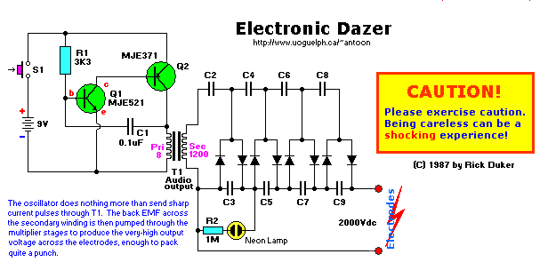

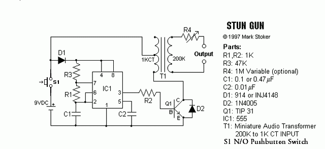

How about a Stun gun or a Dazer circuit?

i want to do the same thing, a spark generator that uses a 9v battery. the purpuse is to make my spud gun go off everytime. i do not like the piezos because the spark isnt always working.
i like the idea of the second daze gun on post #11 because it has repetitive sparks and looks simple enough. but there are a few thing i do not understand about the schematic.
the 9v battery gives DC voltage, and the circuit uses a transformer. arent transformers for AC ? also can someone explain what the transistor do exactly ?
secondly, since i only want a spark to ignite gaz in the spud gun, do i need as much tension ? could i use an op amp to boost the tension and still get a decent spark ? ( i cannot find a transfo, i know they can be taken from old stereo, but sadly i do not possess one.)
else, what is the needed tension to get a spark ? cuz i do not want to electrocute people, i just want to shoot potatoes at them hehe (kidding)

In the first schematic, the transistors take the 9Vdc and oscillate it.
In the second, the 555 creates a squarewave and the transistor boosts the 555 output.
No, you CANNOT use a OPAMP to amplify high-voltage.
To know the voltage to get a spark, you must know the dielectrics characteristics of the media in which you want to generate the spark.
But, for air, it starts at 5kV, usually.
