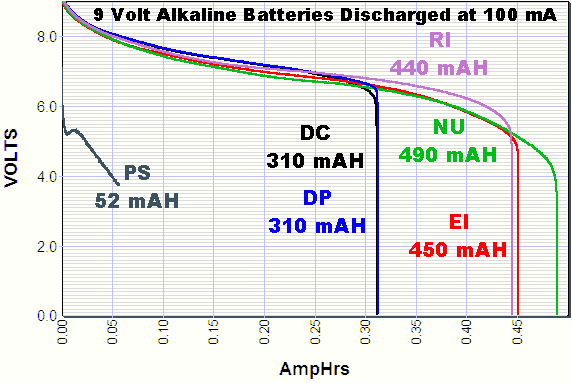

However the voltage on the industry-standard 9-volt battery is, obviously, 9 volts.
er, No. That is a common misconception.
Dry cells start out at somewhere near the nominal rated voltage, but the voltage steadily drops in use, over the life of the cell/battery.
The end point when they are considered totally flat is at around 1V per "1.5V" cell; 6V for a 9V battery.

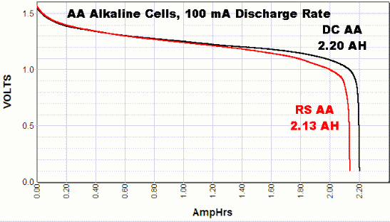

And also the OP stated his torch was working on rechargeables, which are nominally around 1.2 - 1.3V per cell, so mid range in that graph.
