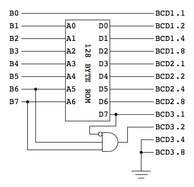

I'm working on a little project calculator and I'm right at the tail end but I'm stuck on this one last issue. I have an 8bit number coming out of my circuit that I need fed to a few 7 segment displays; (Example: Decimal 52, is Binary 00110100). I would assume I need to break this down to BCD but I can not seem to find a way to do so and I don't want to assume that is the correct way to go about this since I can't find much information on the subject. This is all being done on IC's.
Long story short; How would I go about taking my 8bit number and displaying it on one-three 7Seg Displays? Only using IC's, (no micro controller). It doesn't really matter how large the circuit is as I fully understand it may take quite a few chips and possibly need more than one conversion here.

The logic is quite complex to do that conversion with just standard logic gates.
I believe those chips have some sort look-up-table (ROM) for doing the conversion to minimize the amount of logic.
I thought you said in your other thred that you already had the output part working. One suggestion is to have two counters. One binary and one BCD. Load the binary counter with the binary value and then clock it down to zero. The same number of clock pulses would clock the BCD counter up from zero.

You would need an EPROM with a minimum 12-bit output to convert an 8-bit binary number to 3 digit BCD number.
The would require an EPROM of at least 4K in size. A 4k (256 x 16) should work.

Actually, with a couple of external gates, you would only need a 128 byte ROM.

I figured you'd ask.
       D Out
AIn  76543210
