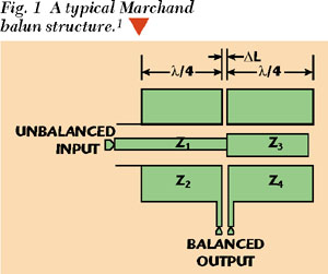

Speaking of planar microstrip components (I think that is what you call em), Does anyone know of any good/practical text, (online or book) on the subject.
https://www.microwavejournal.com/articles/3265-design-of-a-planar-microstrip-balun-at-s-band

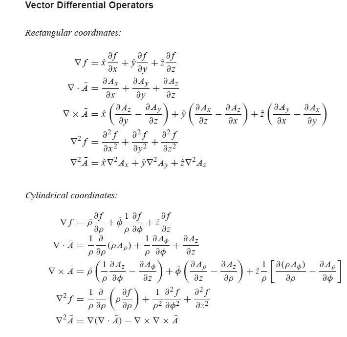

I have a Hard Copy of Microwave engineering, but most of it goes over my head due to the math (I have discalculia or something :)
Example screen shot of book contents.

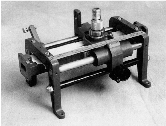

Back when I was in Navy we had a SWR instrument used for tuning waveguide, I guess it was a Lecher line device, I just did not know the name. We called it an AN-SMQ something or other, it was just a hunk of wave guide with a thing that slid along a slot in the waveguide on two rods. But that was back in 1979 :arghh:
The word you are looking for is "Slotted Line".
They were (are still ?) made in waveguide form and coaxial line form.
A probe measures the electric field strength inside the waveguide or coax.
