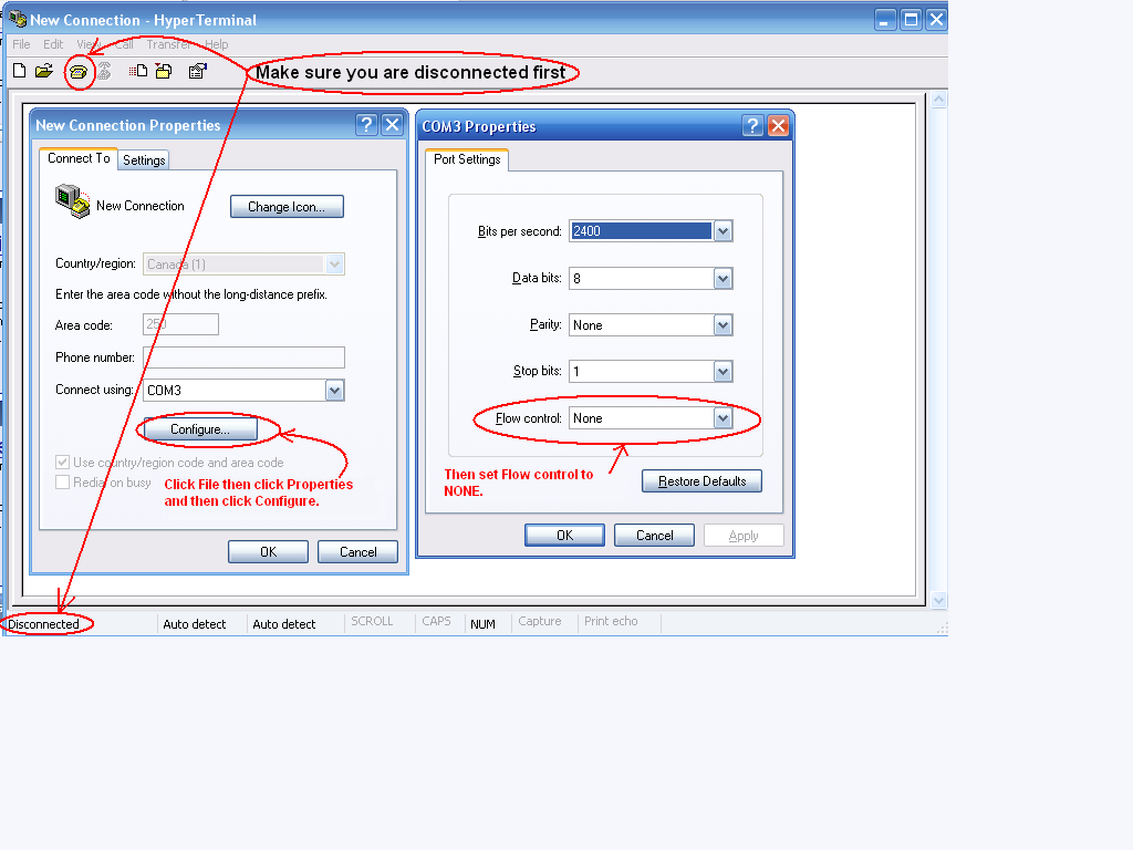

Hi im using 89S52 UART With max232 , the transmitter to pc works fine to hyber terminal but the reciever doesnt work , and the code works fine on the keil UART simulator ! i dont know why the reciever doesnt work , is there a setup for hyber terminal to let the reciever work ?

Try setting handshaking to NONE in "hyber terminal" if you haven't already.
thanks for the reply
what's handshaking i didnt put it to NONE in hyperterminal ..
how to do it
so do u think the problem isnt in the hardware ?
It is one thing of many that could be wrong but the easiest to fix. :)
Look here:
i set the handshaking to none and still the hyber doesnt send charachters :S and the micro doesnt recieve...
