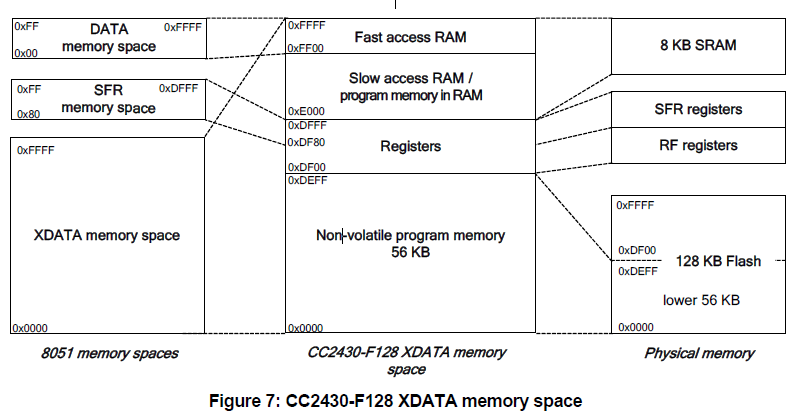

Am I correct that there are the following 3 Physical Memories of the 8051 uC:
1. 8KB Physical SRAM
-- a. 256B of it are fast access - 1 instruction cycle for read/write
-- b. (8KB-256B) of it is slow access
2. 128B Registers (SFR / RF) - Is there a seperate memory for these 128B inside the chip?
3. 128KB Flash Program Memory
This is the memory map:
It is said there that the part of the SRAM from 0xE000 to 0xFF00 consists of Program Memory - does it mean that this part of the SRAM is the cache, which pre-fetchs insructions from the Code Memory?
(Cache is supposed to be fast, but it is said there SLOW Access RAM)
How come the same RAM has 'FAST Access' Part and 'SLOW Access' Part?

So I see that there's the top 256Bytes which are "Direct Access RAM" which are INTERNAL and are single instruction, and there are the rest of the RAM which is EXTERNAL, and is double instruction, right? :)
Could you please refer to what does it mean that the External RAM has Program Memory?

I think you need to grasp the basic concept. Processor doesn't know where the physical memory is. All it does, is sets the address on an address bus and sets up a signal that it wants the memory read. It's up to the perihery memory devices (regardless of whether on the same chip or not) to read the address on the bus, fetch the data and put in on data bus. Once this is done, the device signals to the processor and the processor does with the data whatever the instruction says to do. Processor may have to wait for the memory to respond, so it may add some time to the execution.
Memory can be put on the same chip or outside of the chip. It may be ROM or RAM. It may be slow or fast. But processor knows nothing about that. You look at your map and figure that out.
What happens if I instruct the processor to fetch XDATA from address 0xdf82. What device will respond to the call? You look on the left side of your map and you see the XDATA block. You follow it to the right and see that this address is mapped to SFR. The processor's call will be answred by a device connected to the SFR 0xo2 (note that this could've been accessed in a different way, through SFR data space 0x82).
And conversely, how do I access RAM at address 0x1f10? Find this address on the right and follow to the keft. There are two ways to access this memory! XDATA instruction with address 0xff10 or fast DATA instruction at address 0x10. Take your pick.
Or you want to access RAM at address 0x0500? Unfortunately there's only one way - through XDATA at address 0xe500. That's why this part of the memory is called slow.
Or you want to access flash memory at address 0xf000. How do you do that? No way. Processor doesn't have any access to it through its memory spaces. Must be some other way to access it. Look at the datasheet.

Could you please mention why the memory mapping (which you awesome-ly explained) is required?
i.e. if you could address an SFR by its address - 0x82 - why do you need it to be mapped to XDATA (where you access it by other address 0xDF82)?
I don't think there's any particular reason to do this from the programming viewpoint. They probably did this because it was a convenient way to do technologically.
Using 8-bit address is more efficient on 8-bit processor, but you need 16 bits to address the whole memory. So some important memory locations (registers) can be addressed with 8-bit address.

Is it correct to say that the SRAM which the 8051 uses have 2 'different hardware' sections so that: (is it due to hardware inside the SRAM?)
0xFF00 - 0xFFFF : fast access
0xE000 - 0xFF00 : slow access
Is it common in RAMs that serve embedded uC that they have fast access section and slow access section?
