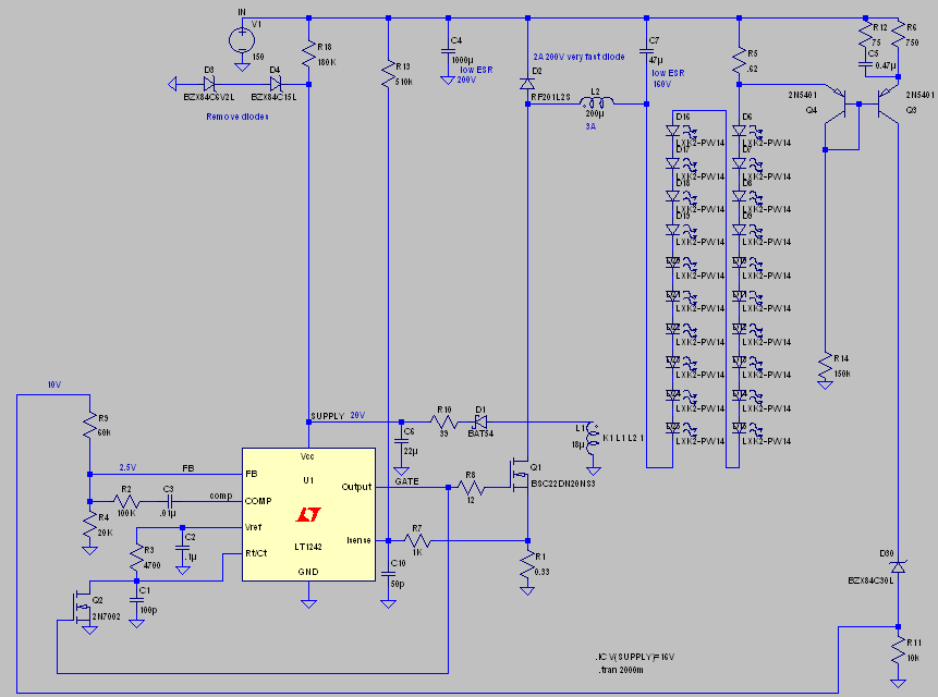

Here is a crazy circuit: Buck down PWM. 150V to about 80V but regulates current not voltage.
80V of LEDs 1.4A
The "150 volt source" is a full wave bridge and capacitor on the power line.
The PWM IC is LT1242 which is like the UC3842.
D3,D4 should be removed.
Q3, Q4 watches the LED current.
It needs some work. There are things I would change. Just a first try circuit.

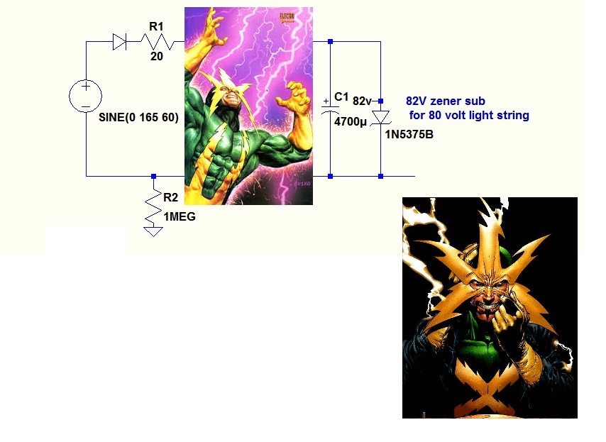

The best is to start with half wave rectification and a resistor and an electro.
I'm sure this is NOT what you meant by electro, please elaborate,
Thanks,
Jeff

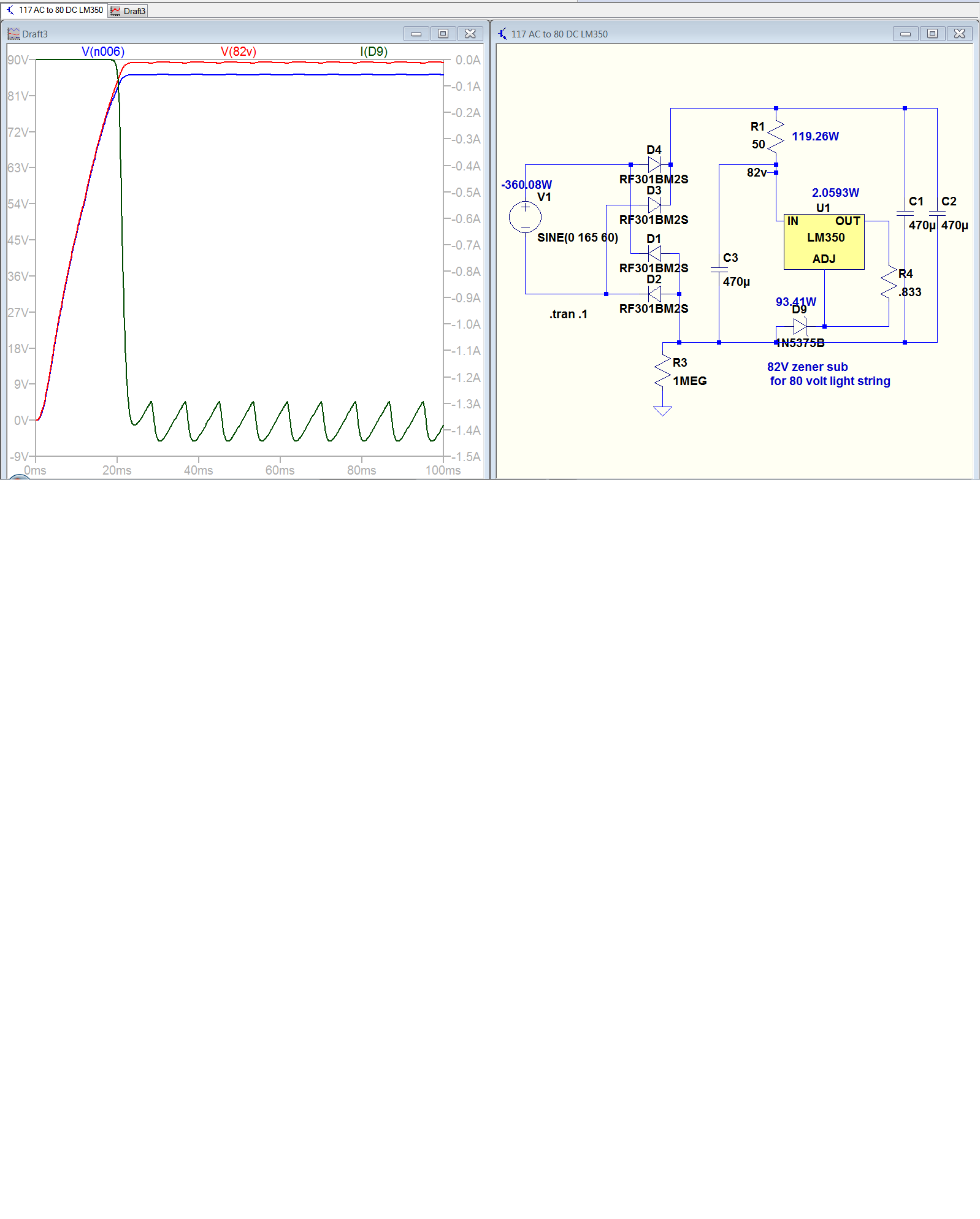

So far, the best I have come up with is Untitled.png, but it is only 33% efficient. Looks like it's time to figure out some switch mode design.
  • 117 AC to 80 DC LM350.asc

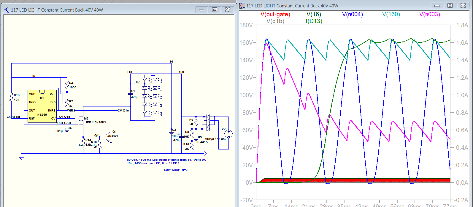

Here's what appears to be a reasonable design, any comments, please and thanks
  • 117 LED LIGHT Constant Current Buck 40V 40W.asc
latest development, this works quite well, but it makes thing buzz and pulls almost 0 current using an Amprobe, I think that's because of the rectification, My computer scope doesn't work with it either.
Any one have any ideas about the buzz, I was able to dampen it with an isolation transformer.
tnx
Jeff

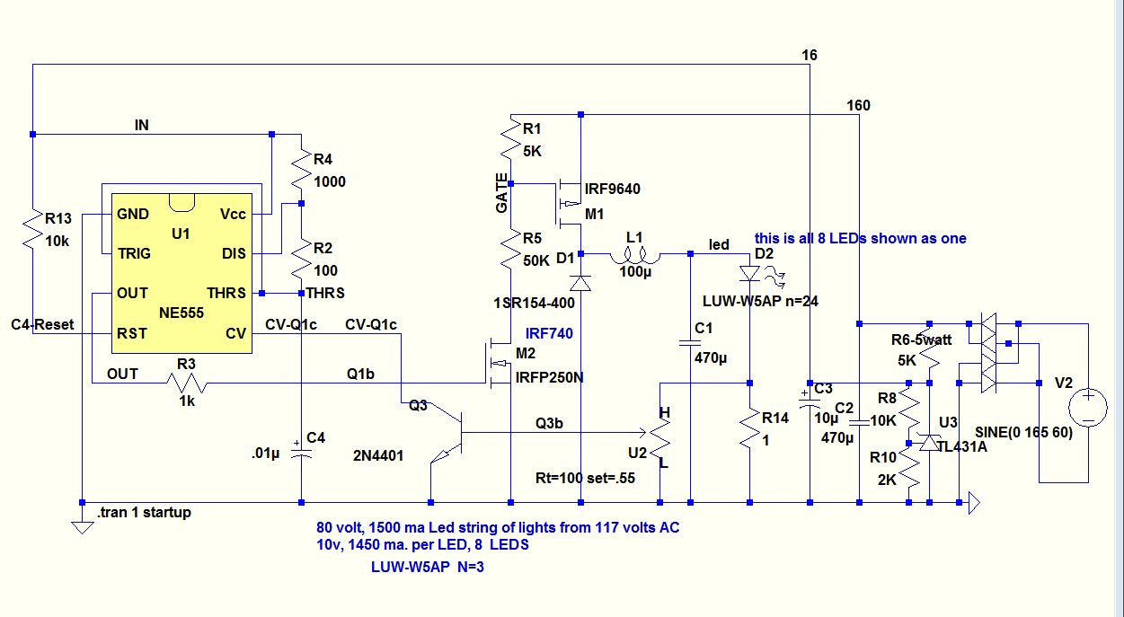

ChrisP58, Howdy neighbor, you're 100% right, take a look at this, I'll have it built in the nest day or 2.
I was also reading about power factor correction, I know the when using this type of circuit, it only draws power form the mains when the sine wave is above, or below, a certain point, 80 volt or so in this circuit, how important is PFC?

Better in principle, but the implementation needs a lot of work.
The mosfet will fail immediately, since you are hitting it's gate with 160 Volts. The simple thing would be to insert a resistor between the gate and the collector of Q1, forming a divider with R1. However, the high values of resistance needed to keep power dissipation in the divider low, also make for a high resistance against the gate capacitance. This means slow turn on/off times, which are problematic in PWM circuits. What you really need is a proper high side gate driver, or gate drive transformer. Or better yet, just use a complete LED controller.
As for PFC, the firts thing is to understand it. Ideally, the current waveform is sinusoidal, and in phase with the voltage. To see what it is in your circuit, just look at the current through one of your AC input diodes.
PFC controller ICs are special boost PWM chips that look at multiple factors, and calculate the correct PWM value to force the current into being sinusoidal and in phase with the AC line voltage.

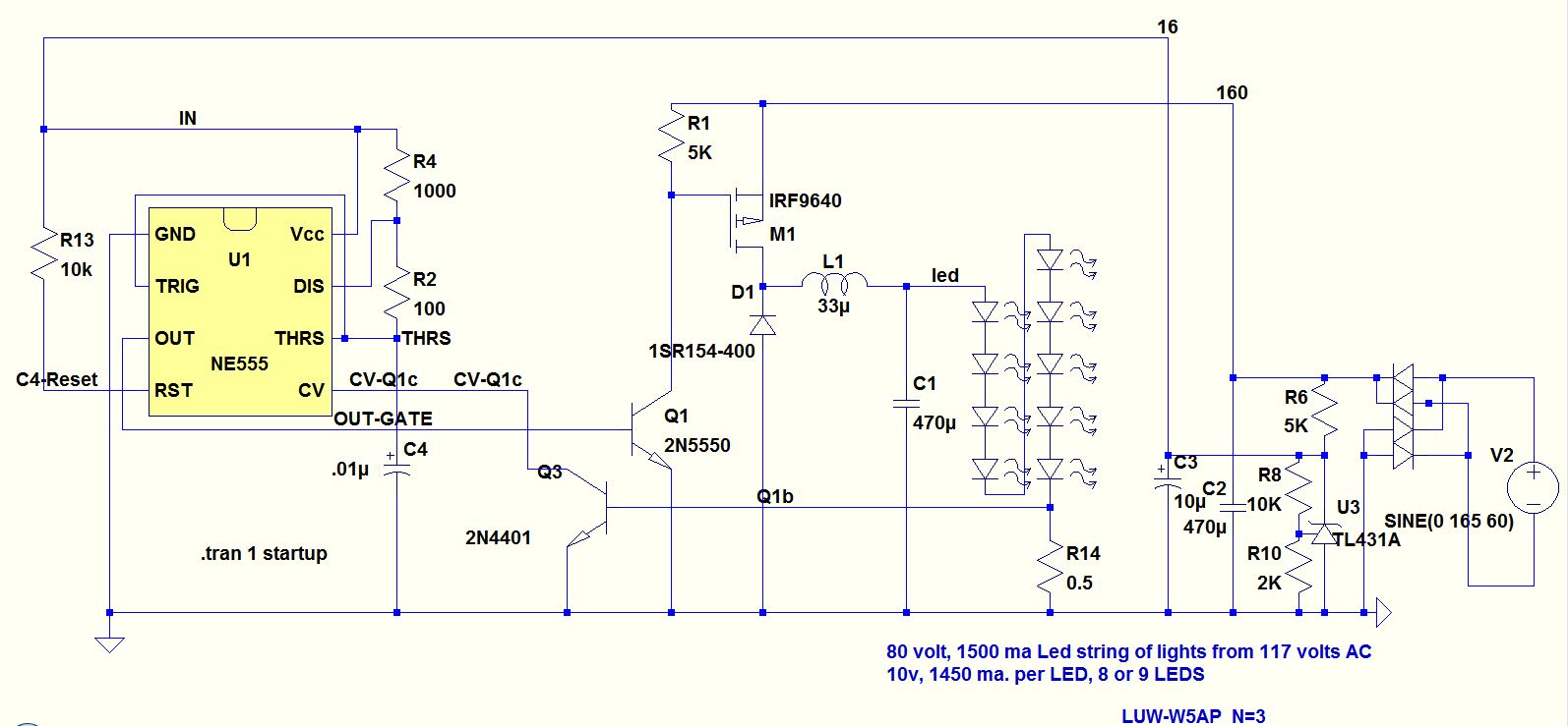

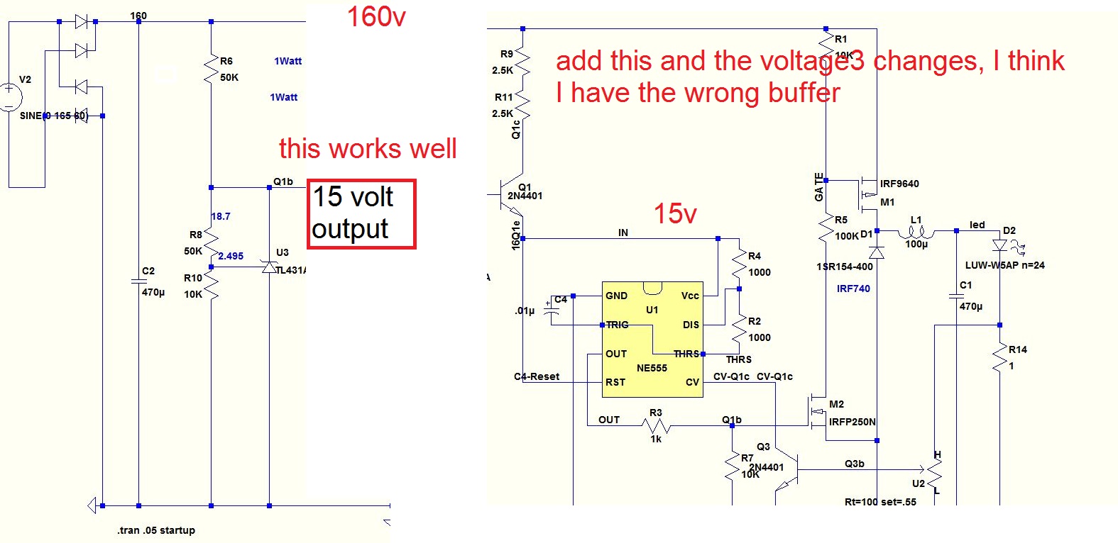

Capture.JPG Here's my nest try, just waiting for some FET's to get here.
Any more advice? Decide not to worry about PF, for now anyway.
  • 117 LED LIGHT Constant Current Buck 2.asc

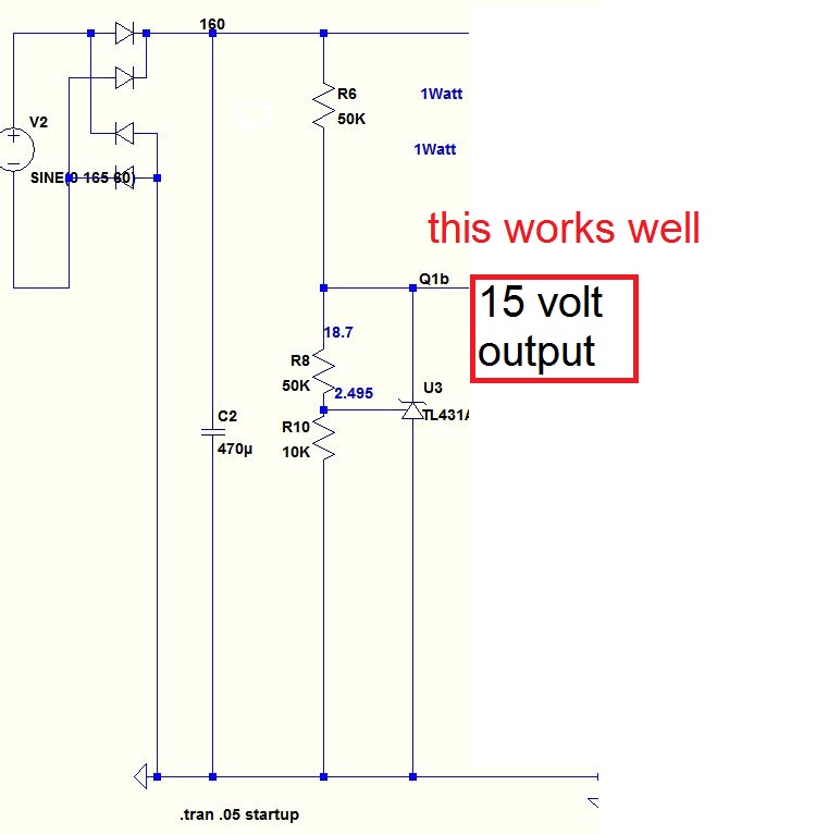

Capture1.jpg This part works nicely, but when I add a buffer ,Capture2.jpg my voltage drops way too much, I think I'm using the wrong buffer, any suggestions, Please and thank you,
Jeff

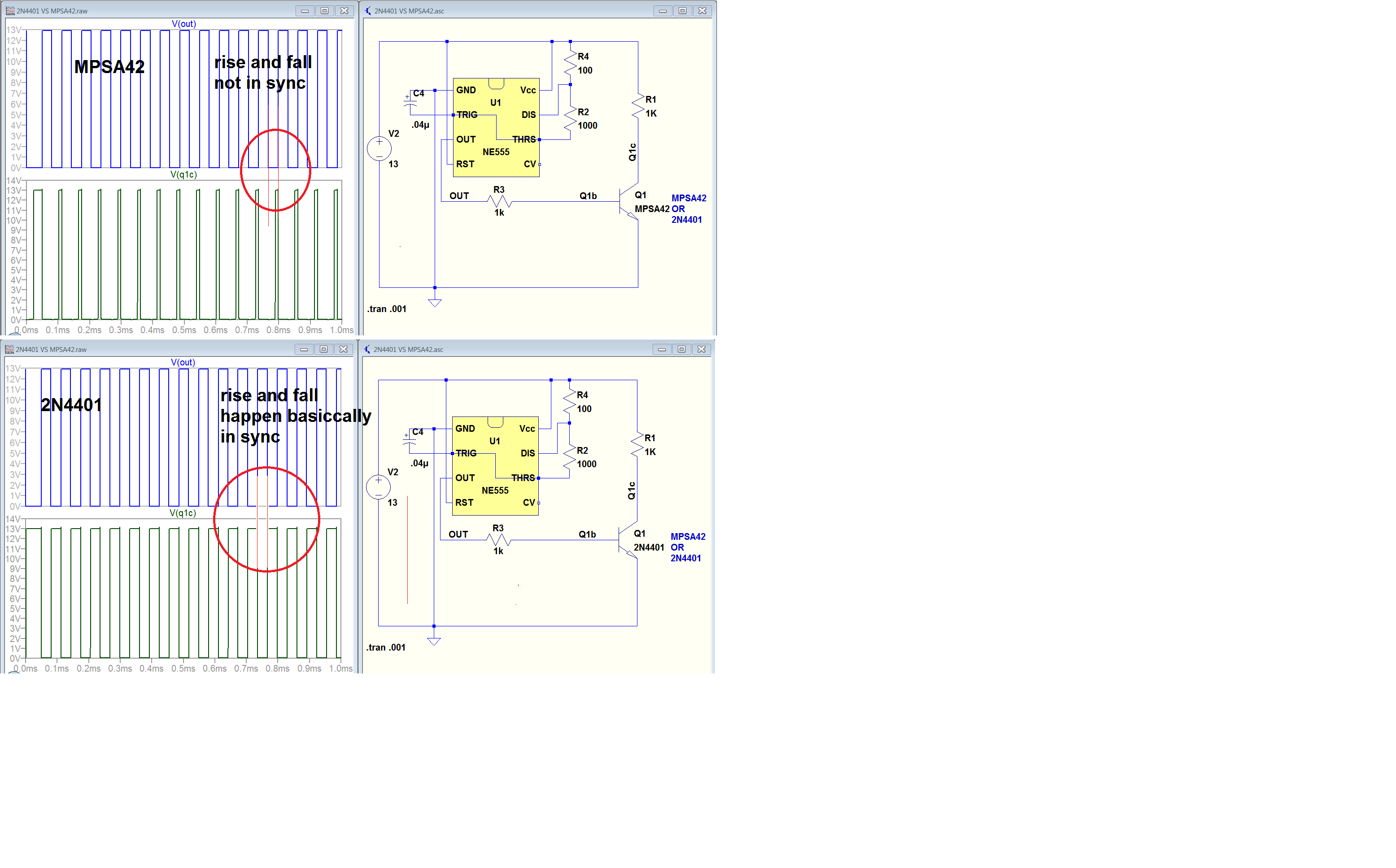

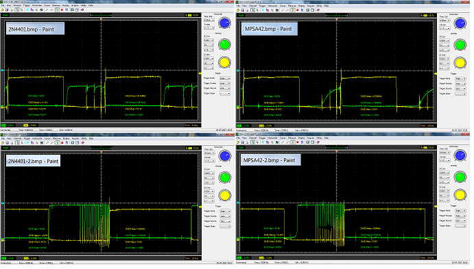

I have received some of my components to continue this project, one being MPSA42, a 300 volt NPN. While testing, I found it has a severe delay in rise of the Ic compared to Ib, it was driven with a 555 output, the same test was performed us 2N2222 and 2N4401 and the Ic rise was basically in sync with Ib.
Can anyone explain why this is?
Here it is in spice,
yellow trace is 555 out
and these are screen shots from testing
  • 2N4401 VS MPSA42.asc
