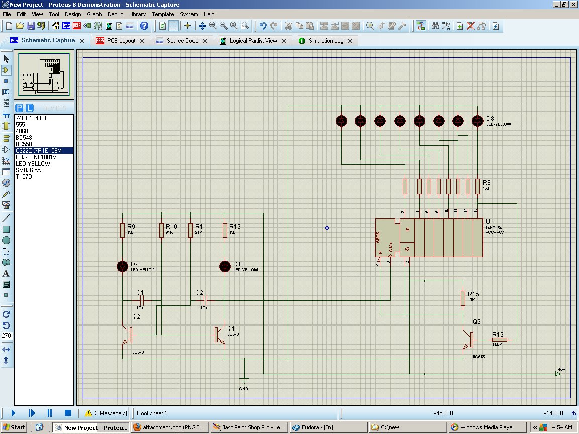

Perhaps I should have included a picture? I'll attach one of the many schematics I've tried to get this thing working and repeating.
I'm thinking that the reason LED #8 isn't firing has everything to do with the fact that I'm also re-directing the last output back to the serial inputs and the reset in different attempts to short/reset/restart the cycle..... but I can't get it behaving properly. My attempts have included using NPN and PNP transistors in various configurations, and putting capacitors along the way to stall the current and allow the last LED to work with the current it should be receiving for enough time to fire. When I remove the "re-direct" jumper from the last pin-out then the 8th LED does fire and the cycle runs once only.
The LED's I've chosen are 3mm green round rated at 3.0-3.2V x 20mA. I'm using 470ohm resistors between the pin-outs and the LED's.
And yes Alec, having now read a lot of forum posts on sequencing LED's I am interested in playing with LM3914 at some point, but for now I'd rather see if I can get a working circuit with the materials I've already bought.
Wolf

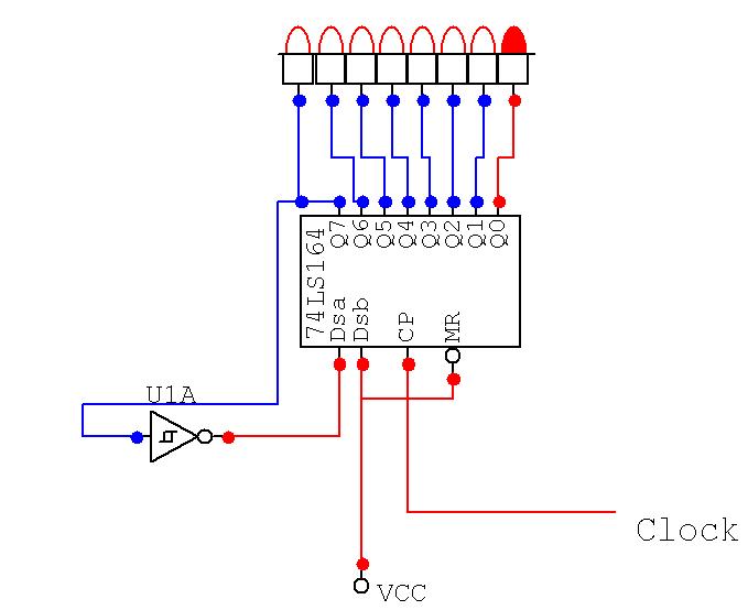

may be you need some thing like this circuit....View attachment 74646

I assume the cathodes of your LED's go to GND even though you didn't draw that out...
Also, I had to look up the symbol marked "U1A" (I'm very new to this stuff) and I don't have anything like an inverter in my stash to test your design. Can I make an inverter with discrete components?

yes it should be grounded....... i had used just logic indicator (instead of LED< you have to use LED) in the schema for reducing wiring..... ...
yes you can make a inverter with 1 transistor and 2 resistor .....Inverter with trnsistor.JPG

@Eric: My Adobe was eventually able to open the PDF without errors..... I'm still hoping to make the materials on hand work for me b4 experimenting with new devices. Thanks.... :b
@Ikelectro: Thanks for adding that second diagram of the inverter. When I put the two pieces of your puzzle together it looks identical to a schematic another fellow had suggested and which I'm 99% sure I had tried..... but tried again last night.
In the Proteus 8 Demo software I D/L the circuit sequentially fires and latches all 8 LED's, then it sequentially turns them off one by one to complete a cycle. With hardware on my BB however, I'm not getting that behavior at all. (This is not the first time I've seen things work in software but not hardware, or vice-verse).
I get the feeling that I'm making a very basic mistake somewhere on the BB (which folks like you would see instantly), but even after I look at it 100 times (which I have) I just don't see the problem.
Perhaps I need to add a toilet flusher handle? :b
Thanks guys.... I'll keep playing with it....
Wolf
Hi Wolf, let me assume that you have placed the hardware as the circuit i had supplied to you... So now we can also assume that your Vcc is 5.5V or 5V. And you should get this volt on 74164's pin no. 2,9 and 14..... and pin 7 is gnd..... and you have clock pulses on the pin no. 8... just make sure these things...... hope you are using a multimeter to find that out...

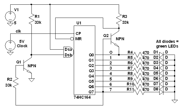

This will do it....
Edit: You could use 10k instead of 33k in the above circuit (at the expense of greater current).

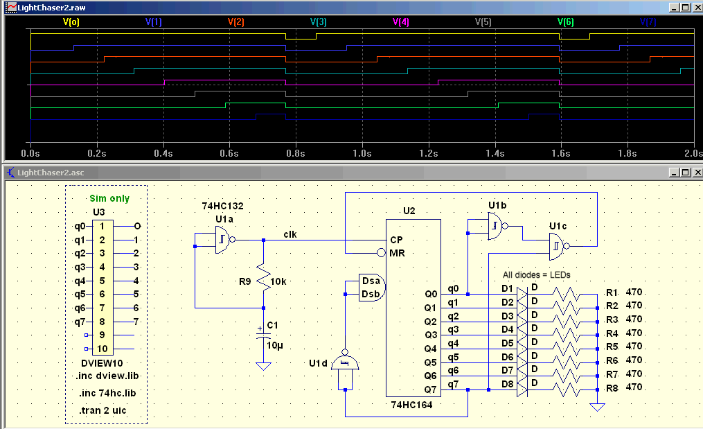

To reduce the component count you could use this circuit:
The 74HC132 is used to generate the clock signal as well as to do the logic for resetting the LED sequence.

@Alec: Just tested your "all off" schematic...... works great! Thank you Sir.... :b I don't have any of the HC132's, so that will have to be tried another day. I noticed in that (2nd) schematic you posted that the resistors are at the cathode end of the LED's.... I thought they should always be at the anode?
