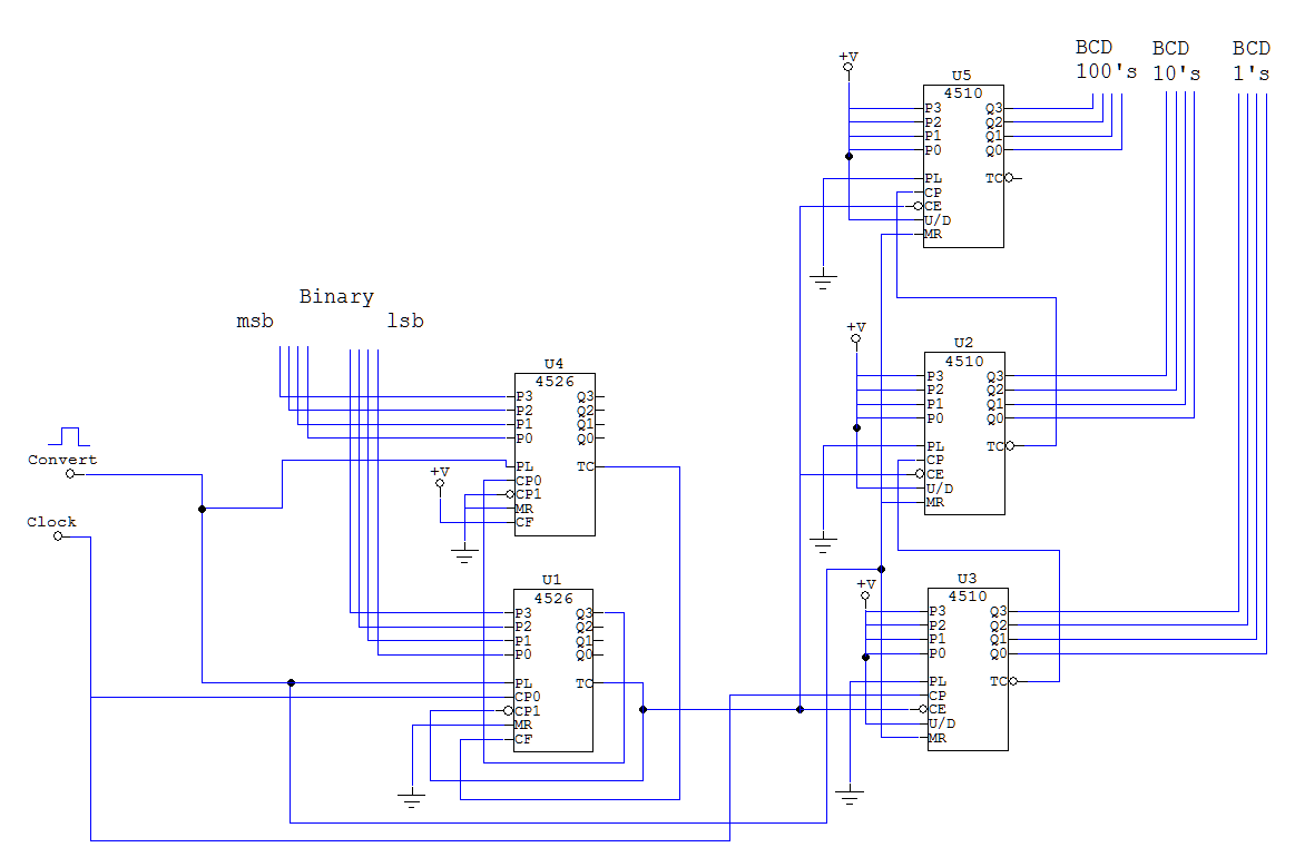

This provides the Binary to BCD conversion. Use BCD to 7-seg decoders like 4543, or 4511 for the displays.

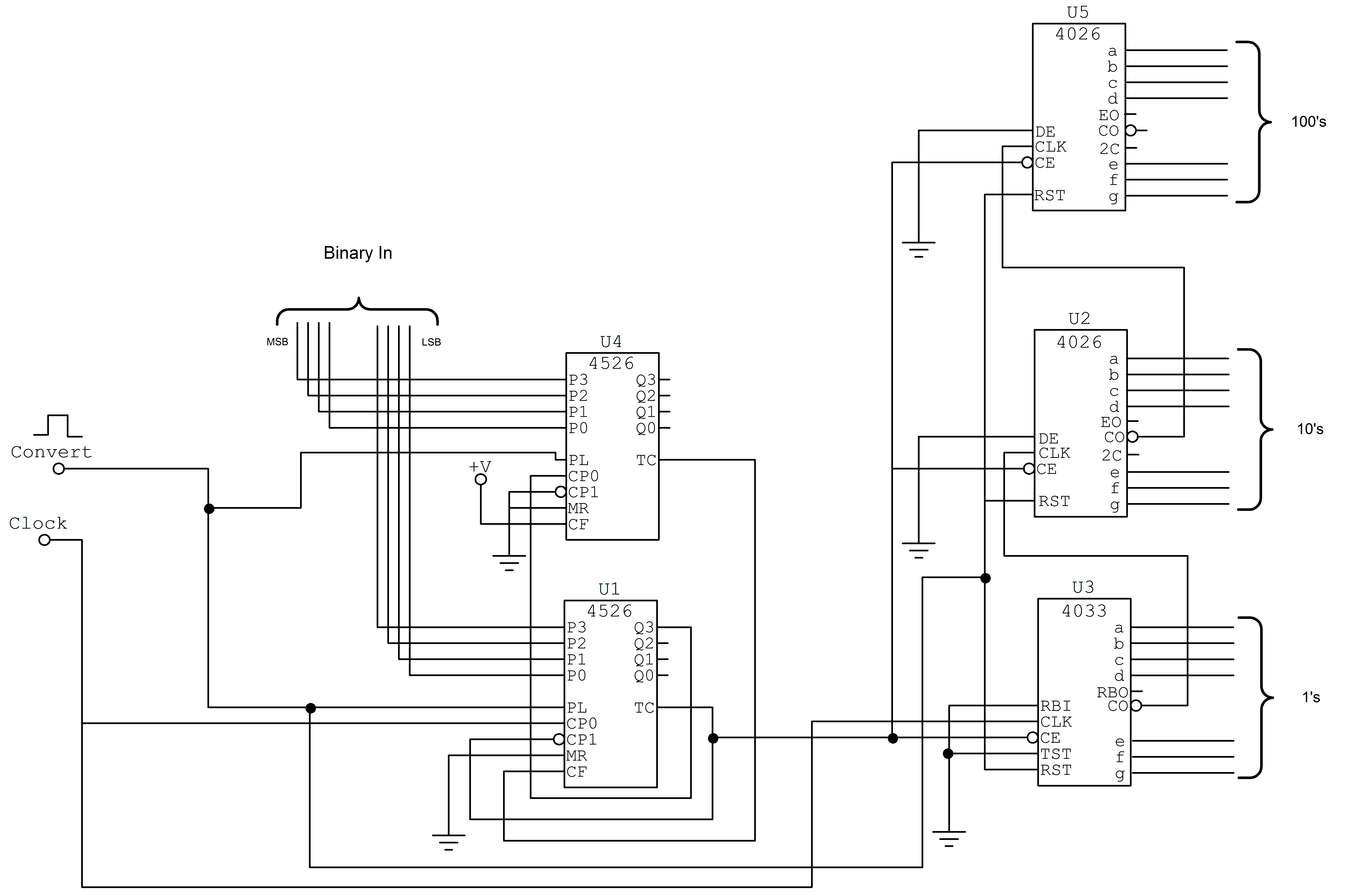

Edit: Okay, so it wasn't so much work afterall. Ta-da! I even threw an example of using the 4033 in place of one of the counter/decoders instead of the 4026

1. Can i use 4510 instead of 4526. because 4510 can make. down or up counting. If yes then what'll be
the circuit.?

Sorry. I can't bring up your attachment. I get an error. The 4510 are BCD counters and so they cannot be used in place of the 4526 binary counters.

ok, i understand... then i have to use 4526 instead of 4510. but can I use all decoder 4026( in your circuit there is a 4033 and two 4026. is there any special reason for that combination of 4033 and 4026? is that possible to use all decoder 4026?)?
You can use all 4026. I only put the one 4033 in there to show how a 4033 would be connected.

IN THIS, what no. of pin is CE, DE, EO and 2C.plz reply as soon as possible.!!thanks.
CE = pin 2
DE = pin 3
EO = pin 4 (unused)
2C = pin 14 (unused)
