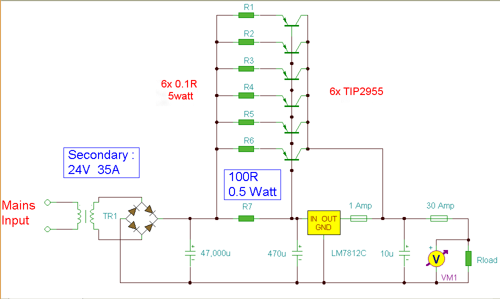

Why not use a transistor, or several of them to "up the current"?
an old psu I made a good few years ago used an LM317 (adjustable voltage regulator) but low current I think it was 1A max? not sure it was many years ago
and a bank of 2n2222's to bring the current up to around 20A
I've lost the circuit many years ago, but the attached one gives you a basic idea to work from

... an old psu I made a good few years ago used an LM317 (adjustable voltage regulator) but low current I think it was 1A max? not sure it was many years ago
What was the board size of that device?
It takes a bank of at least 34pcs. 2N2222 to get 20A out of the circuit. :D
