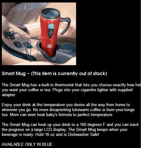

By "Smartmug" I'm guessing you have a heated mug with a thermostat. And by 9V I'm guessing you want to use a 9v battery.
Heating coffee or even keeping it warm requires more power than such a battery can supply. If it was a 9v transformer it would have to be fairly large one too, bigger than you might find on an answering machine for example. Like probably at least a couple of amps. Of course in getting a transformer it would be wise to get a 12v one to start with too.

We are talking about a mug with a heater in it that runs off 12V from a car. Its heater probably uses a current too high for a small battery.
no we're not. :D
I got this mug from target and its definitely kind of cheap. It doesn't heat anything. It only has one button on it. On and Off. and all it does is tell you the temperature and how full it is. but it has a car hookup just like that one.

Here's what I think.
Your smart mug has a heating element in it, as almost all other smartmugs from Target do.
Check their website.
What is the point of knowing the temperature of the liquid in your mug, if you have no way of altering it?
Is that fancy Display to let you know when to drink up or when its to cold.
No.
Also, why would you want the adapter, when 4AAA bats, will last a long time, monitoring level and temp.Unless you wanted to heat something, then they are no longer suitable.
Those batteries are there just like your clock radio needs them to keep time during power failure.
