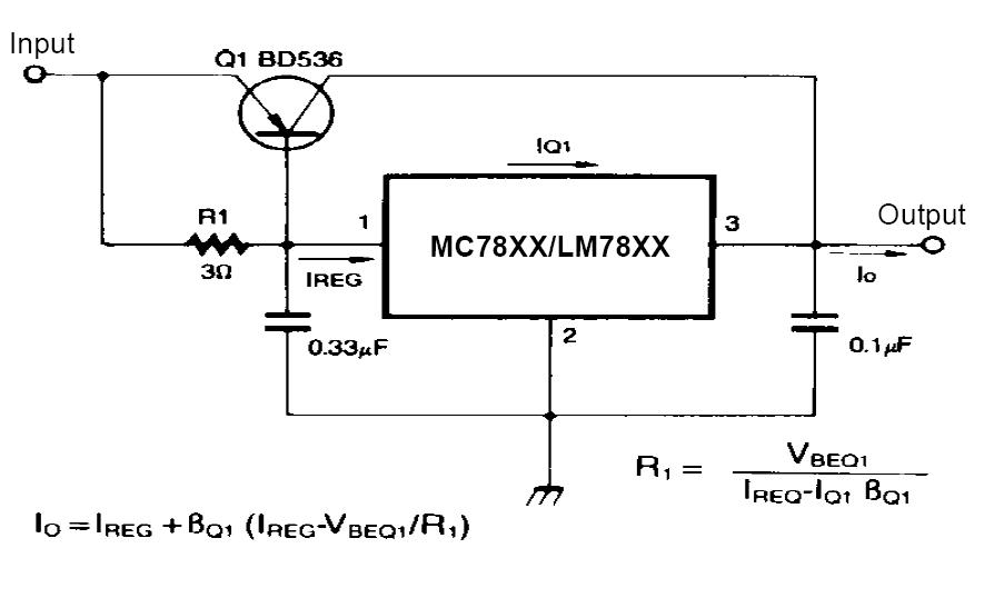

i need to run an lcd with backlight and a microcontroller and a medium sized seven segment display with a common 5v regulator. Total current consumption could be possibly around 600 mA . what regulator would be the best choice in terms of cost and performance...??
retrieved this from an old post
if u add up two 7805s and the resistors, u will be better off with a single regulator that can handle more current
i got the solution. see 7805.jpg this should work fine if im not mistaken
but whenever i use switch the backlight of lcd(16x2) ON the circuit becomes very dull and the alarm seems to cry weakly..
and in another circuit where i use a 128 x 64 lcd the circuit refuses to work at all when i swithc the backlight on...

Then the backlight is overloading the power supply.
