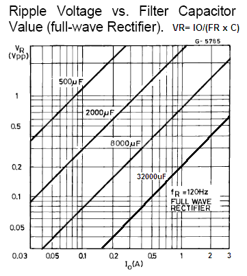

I use this graph for determining the value of a filter capacitor in a full-wave rectified circuit with a 60Hz mains. It shows the current and the resulting amount of p-p ripple voltage.
