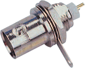

Hi I've been to the boot sale today and picked up a bag of BNC connectors (about 50 chassis sockets) for £1. Can't go wrong.
However some are 75 ohm and some are 50 ohm I have some ideas in mind for the 50 ohm sockets but just by sight how do I know one from the other.
I have researched on the web but sellers just use the same photo for both types. anybody know how to tell them apart ?.

Now they are connectors and not terminations right? Usually the 75ohm coax has a slightly larger diameter than 50ohm (In the same loss/grade category). You may be able to determine the type with a pair of vernier calipers or just try and insert the core of a 75ohm coax into one. If it doesn't fit, it is a 50 ohm connector.

Chassis Sockets
They are chassis sockets.
A DMM will tell me nothing they are sockets.

A BNC connector at any impedence is the same size.
My origional question still stands.
Is there a way to tell the difference visually ?
Ps 50 ohm and 75 ohm is their impedence not their resistance.
Oppps. I was thinking of BNCs that would go on a coax cable end. The one in the PIC is not designed for high frequency use and no matter how you wired it would show up as a impedance anomaly on a TDR (Time Domain reflectometer) because there is no way to maintain the characteristic impedance of the transmission line when going from coax to connector.

No, but that the internal structure and materials are different. The parts that plug together are the same sizes and this is why BNCs aren't really that good of connectors for RF, but are great for test equipment connections due to their ease of removal/attachment.

Are all your connectors this style? Any without the solder tab for the shield? How do you know that you have some 50 and some 75 ohm BNCs in the first place?
I intend to use these for video signals conecting to long cables.
The Box is labled as BNC Chassis sockets 50ohm / 75ohm
They are all as in the picture
The solder tab is connected to a washer so is removable
Don't worry about!, it will make no difference for your video signals which ones you use - incidently, for video signals it should be 75 ohms - and normally 50 ohms for RF use.

As pointed out in a previous post, for your video application it will make no visible difference to the signal quality.

The male pin in the 50 ohm BNC coax connector is slightly larger in diameter than that of the 75 ohm BNC (this is how they get the different impedances). The female receptacles in the two connectors are correspondingly sized. The difference is subtle to the eye, but if you plug a 50 ohm coax into a 75 ohm receptacle, it will spring (distort) the receptacle. If you then switch back to 75 ohm coax, the connection may be unreliable.
I don't know if 75 ohm coax plugged into a 50 ohm connector is reliable or not.
EDIT: I just now read the Amphenol page that Eric referenced. They have obviously solved this problem, but the fact that they mentioned that the two connectors can be mated nondestructively suggests that it was a problem in the past. As I said, I encountered the problem many years ago - like 30. Surplus connectors could have this problem.

Both pins of 50 Ohm and 75 Ohm plugs have the same diameter in the mating area. Therefore, both 50 Ohm and 75 Ohm connectors mate mechanically without any physical damage.
I am certain this was not the case in the early '70's, at least not with the brand we were buying.
