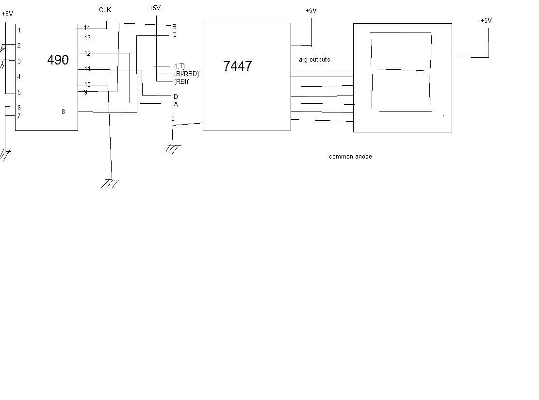

Ok, here's the circuit... Maybe I might have left something here! :D

So the etchersketch is still around :) For starters you need current limit resistors between the 7447 and the display.
If you want to make nice schematic drawing, might I suggest this free download, called Eagle.
I only say this because your drawing is, how do I put this...

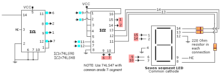

Attached is a little better drawn circuit, also done with paint, by the way.
It uses the 7448 and drives a common cathode, but the connections are the same. What are you using for clock, and are you using by-pass capacitors across the power supply? The latter is very important with counter circuits.

In reference to original circuit.
You need to connect pin 1 to pin 12 of your 7490.
Oh, just noticed. Allvol circuits shows that. never mind...

Get 1 digit working first. You need to tie pin 1 to 12 of your 7490 or it won't work right. Add the current limit resistors as well.

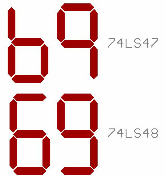

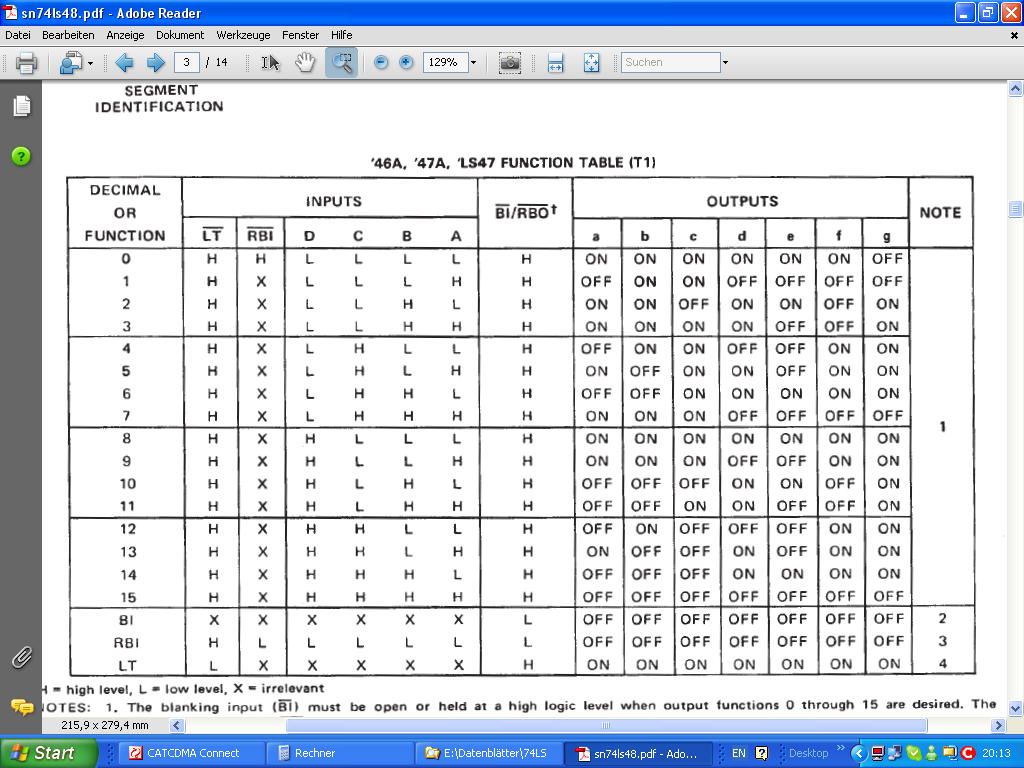

74ls47
Hi littletransistor,
accidently there was the right advise from another member here. He uses 74LS48s as a display driver.
LS47 and LS48 are identical decoders with a slight difference. Sixes and nines are displayed with a 'tail' using the LS48.
Both of them are COMMON CATHODE drivers.
The TI datasheet truth table says clearly to display e.g. an eight all segments are on (high), which calls for a common cathode display.
Here is what the display looks like using an LS47 and and LS48.
Regards
Boncuk

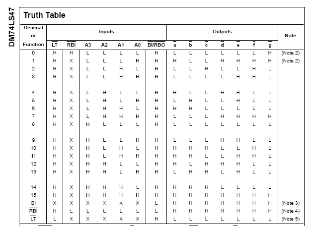

Nope. 7447 drives common anode seven-segment LEDs. See attachment, showing it sinks current through the segments. Note the "zero" in which all segments are rendered LOW except for "g".

TI lies! Here is my datasheet, showing all segments high except for "g", which is low displaying a "zero"
Yours shows the state of each segment... on or off.
The other sheet gives the condition that results in the segments state.
