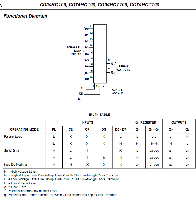

Have you looked at the data sheet for the 75HC165? What don't you understand?
I've looked at it and dont understand that much. I want to input data without the need for a constant clock pulsing evenly.

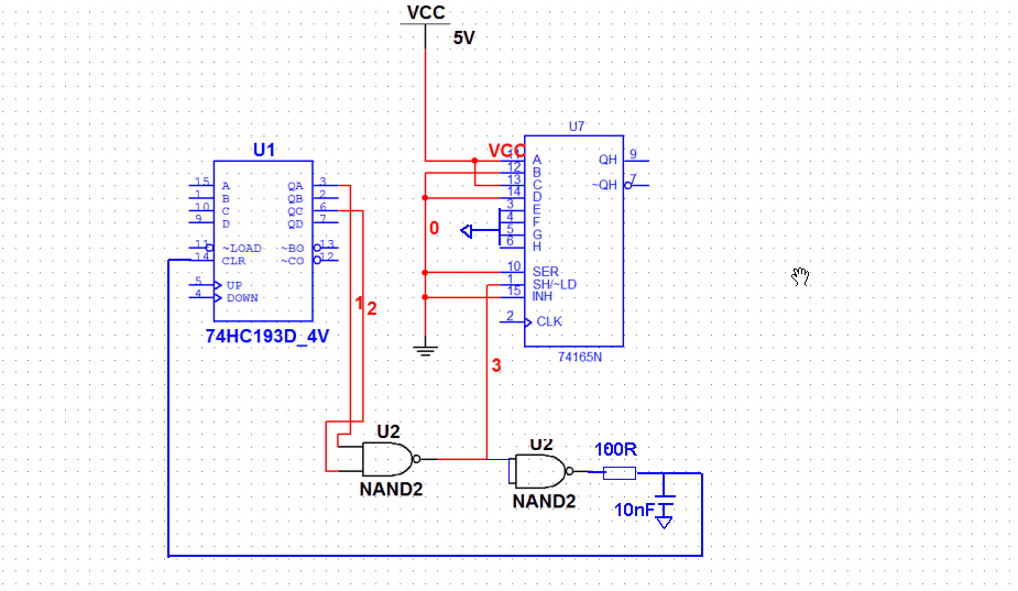

As the count is always '5' why not hardwire the '5' bits on the parallel input and use gates to detect the 5th count of the 193 and use that as a PLOAD pulse.
You still need the 8 clock pulses to clock out the S/R.
you mean like this
Yes, but dont forget to connect the other 4 input pins to 0V, because when disconnected on a 165 the will assume a high.
By inverting the PLOAD from the NAND gate, using another NAND or INVERT you could auto RESET the counter
it works but only on the 6th count. i connected the nand gate to the pins 3 and 6 i.e. 1010 = 5. not sure what the problem is.
Do you mean the PLOAD or the 193 RESET.???
At the 5th count PLoad will go low and load the '5', to enable the 165 to shift the PL must go high, thats why I suggested the auto Reset of the 193.
By clearing the 193 count, the PL will go high, enabling the shifting.
You may find that you will have to add a short delay in the RESET by adding a res/cap in the RESET line.
Do you follow.?

Could I connect the counter output pins directly to the PISO input pins with hardwiring the pins to 5?
thank
thank
You should be able to put the 165 parallel input wires directly to the 193 outputs, is that you mean.???
Keep the top four 165 pins connected to 0v.

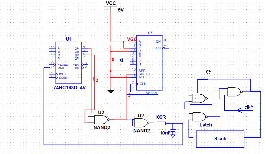

When you have that part working, you need a LATCH, you can use two NAND gates.
The LATCH would be set when the 165 is loaded with the NAND gate '5' detect circuit.
With latch set, gate clock pulses into the 165, to shift out all 8 bits, when the last bit is detected reset the latch.
You will need a 8 count detector circuit.

this is an option.
