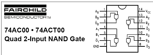

Hi all,
Have a question here. In the attachment there shows 4 NAND gates. Do you guys know how I can determine which is those each pins on the IC?
Because I try to find on the datasheet but didn't manage to find the pin configuration for the connections in the attachment?
Appreciate you guys' help.
Thank you.
All datasheets show the pin numbers for each of the 4 gates in the package.

thanks for reply. But how can i know which puns correspond to which NAND gate?
what i mean is for example, pin A0, B0 and O0 correspond to which NAND gate in the circuit?
or every NAND gate is the same one?so we can ramdomly connect them?
Nand Gates
You would go in on 1 and 2 out on 3 = 1 nand gate
in on 4 and 5 out on 6 = 1 nand gate
in on 12 and 13 out on 11 = 1 nand gate
in on 9 and 10 out on 8 = 1 nand gate
Pin 7 goes to GND and Pin 14 goes to +
