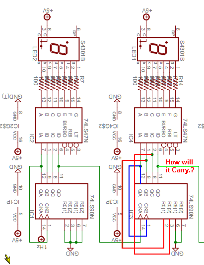

There are a number of errors on the circuit, it would take a while to check thru it all.
But as this clip shows you have two outputs connected together.

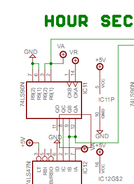

OK so I applied the frequency divider with 7490 (MOD-6 counter for tens of second and minute section and MOD-3 counter to the tens section of the hour section). Kindly check out the modified schematic and tell me what you think. Thanks!
Look at this clip from your circuit.
BTW: link 3,4,5 's together on the 74LS47 while testing.
If you have not bought the 74LS90 look at the 74LS92 for the '5's they are a 2+6 divider.
Use the 6 divider section for the 'tens of sec'
Hmmmm... Do I have to use an AND gate to it?

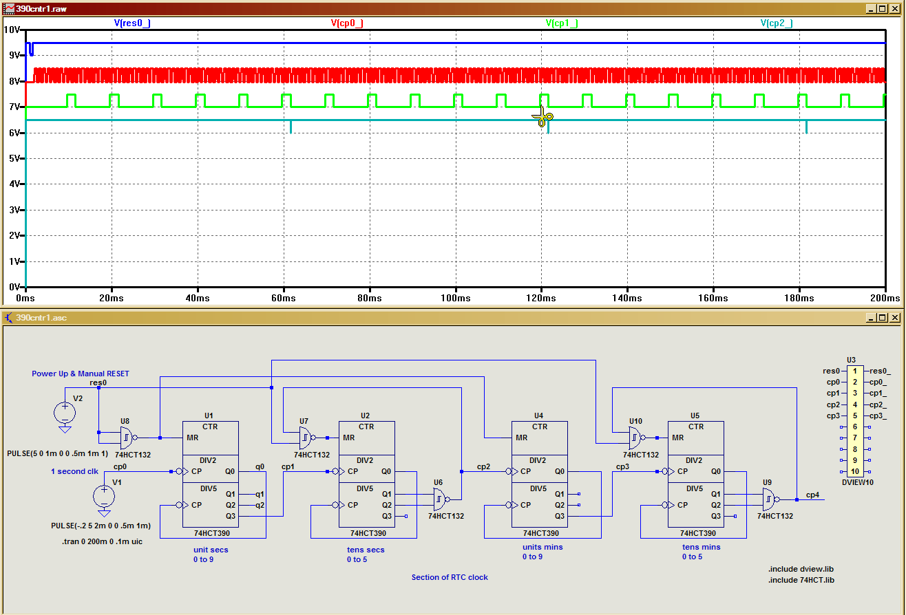

Look at this LTspice simulation of the seconds and minutes section of your clock.
I have used a HCT390 counter as I dont have the LS90 model, but the action is the same.

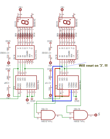

I will check the '24hr' reset, the '5's look OK.
EDIT:
The hours will reset on '39:00:00"..
Hint: you need to detect '24' , so that 1 wire from hours units '4' and a wire from hours tens '2'
thru an AND gate..[or if you prefer R0/R1 resets] .OK.:)
