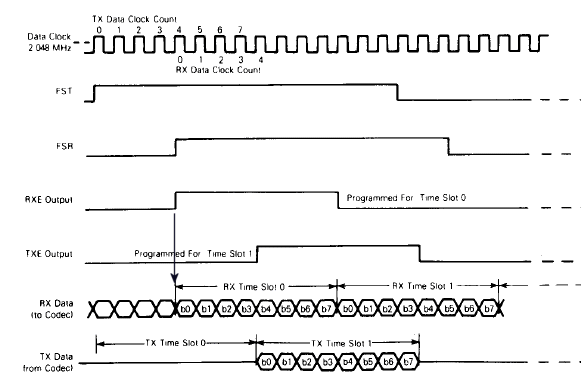

I think I see your confusion. The mux chip you mentioned selects 1 of 16 inputs based on an address, so only 1 of 16 inputs is available at the output at any one given time. I think what you are thinking of is more of a Time multiplexed bus. See attached timing diagram of a TDM bus
Sorry Eric, not trying to poop in your thread...
