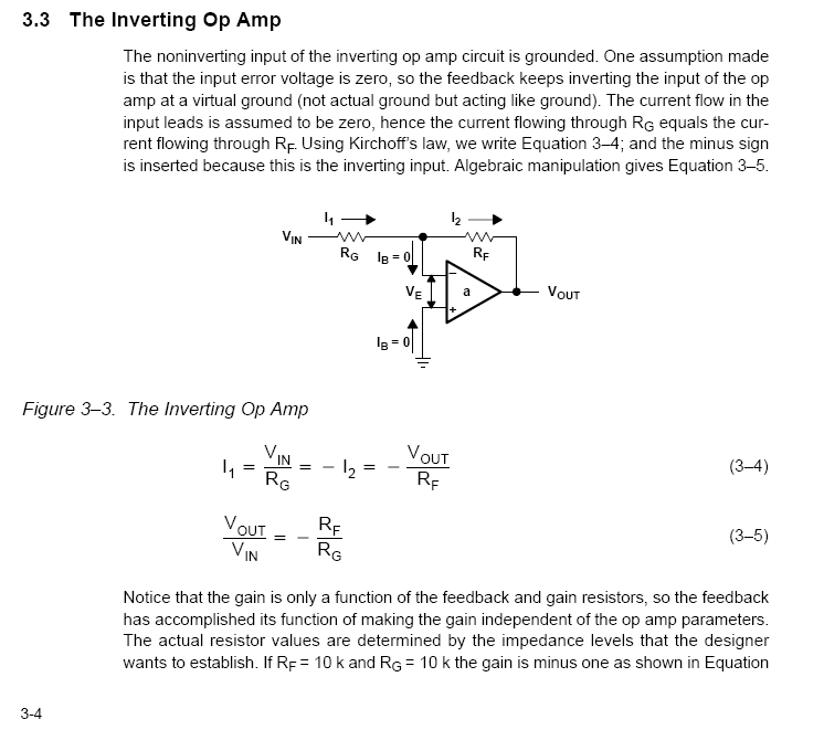

I'm new to the 741 op-amp, and I'm trying to understand some basic concepts, like what will happen if the load resistance is low and approaches the output resistance of the 741 op-amp? (The output is feedback into the negative terminal with the positive terminal grounded creating an inverted output.)
My though is the low resistance will increase the current that is feed back into the negative terminal, but i don't how that will effect the 741 op-amp. Also with the low resistance and high current the input voltage will be greater at the input, and in fact decrease the gain of the op-amp, and the output voltage will be low. Does anything else happen or am I way off on everything???

You a bit off on your understanding of how inverting opamps work. For an inverting opamp, the current in the feedback resistor is equal to the current in the input resistor (because the current into the inverting input is essentially zero).
Every opamp has a maximum current it can source or sink from its output pin. Some of the output current from the opamp flows through the two resistors back to the input source and the rest flows into an external load that the opamp is driving (if any). When picking the feedback resistor, you have to choose the resistors so that the max current of the opamp is not exceeded.
You need to understand the figure below, which came from this reference.

Take the circuit Mike posted and put some values in there… Rg=Rf=1K and Vin=10V
The plus pin is tied to ground. This means (#4 above) the – (inverting input) will want to be at zero volts.
Since the inverting input want to be at zero volts, that means that Rg has Vin minus the inverting input voltage across it, but because the – pin is at zero, the voltage Vg appears across Rg, so Vin/Rg= I1 or 10V/1K=10mA
Since current can’t flow into either of the input pins (#1 above), and it has to go somewhere, the only other path is through Rf, so I1 = I2 =10mA
10mA through 1K will be 10V, but current flows from plus to minus and the “+” end of the resistor is at zero potential. That says that the “-“ end of the resistor has to be 10 volts below that potential, or the output of the opamp is at -10V (#5 above).
With “real world devices”, there is some input bias current, input offset voltage, max output current, etc. but for learning the basics, just apply the rules.
