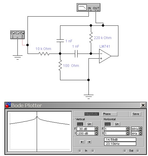

I did the simulation in Electronic Workbench (also a Spice simulator) and I got a peak frequency of 23kHz, close to what you measured (see below).

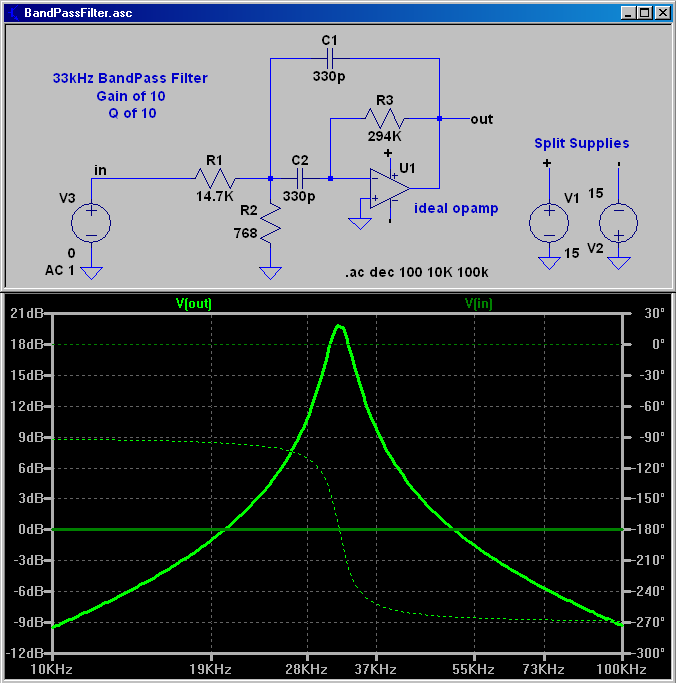

Did you notice the excellent bandpass curve posted by MikeMl when the opamp is "ideal"? The lousy old 741 opamp is completely different.

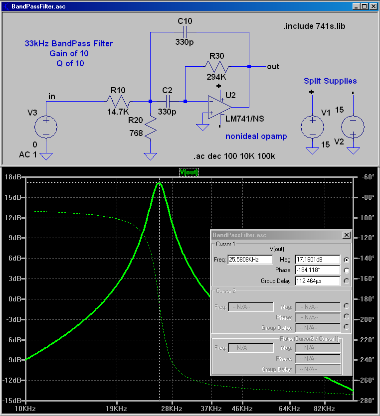

Here is the LTSpice repeated with a 741 model. Note the reduction in gain, and the shift of the resonant peak...
