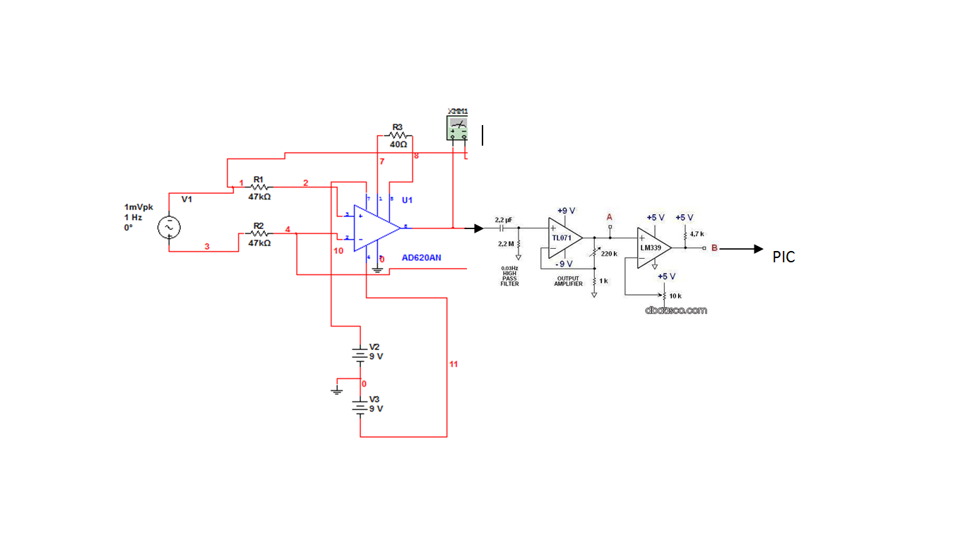

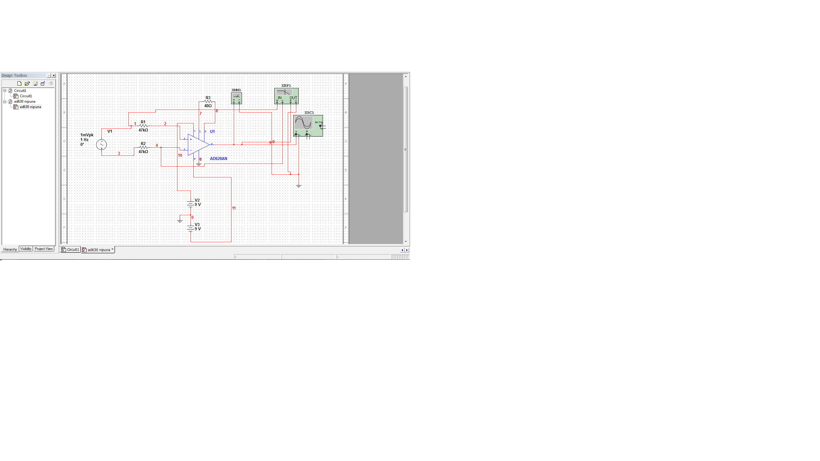

i will post the circuit that i will use it, the first link was one of the idea i found, but the circuit that i tested using MULTISIM 10 is working and i you can check it out below.
thanx for ur help
I should have been more specific about the specific circuit I was referring to. The circuit I was talking about is the circuit from your first link with the micro-controller and 7 segment displays. The circuit you have attached to your previous post is the circuit to amplify the voltage measured from the person and for all intensive purposes can be developed separately from the micro-controller portion. The amplifier portion will connect to the PIC ADC or comparator input. Then the PIC (using software) will have to count the pulses, calculate the average over a fixed time, and then display the output on 3, 7 segment LED displays. The circuit shown on the page from your first link shows one way to do this but the C code from your second link will not work with the micro-controller circuit in the first link. Do you realize this? Are you going to design the micro-controller portion to work with the C-code in your second link or are you going to design the micro-controller circuit as it's shown in the first link?
EDIT: Also, what PIC do you plan to use?
ok, the translated link i post just where i can connect from the part (B) to the PIC, as you know i must get a voltage goes to the PIC around 3.3-5V, SO the only thing i needed it is use the circuit i did and tested by myself using mutlisim 10 and connect the PIC to it.

OK, but that circuit has no micro-controller and no 7 segment displays to show the output. That ciruict will only amplify the voltage measured on the body. The output of that circuit must be connected to a micro-controller ADC or comparator input. Then, software must be loaded onto the micro-controller to process the input and drive the output displays. That is what the circuit in post #14 is doing. The circuit you have in post #17 won't work by itself. It needs to be connected to the circuit in post #14 or a similar circuit in order to calculate pulse rate and display the output. I cannot make the C code work for you unless I know what the micro-controller part of the circuit will look like. The C code you linked will not work with the circuit in post #14 because it was written for a different circuit. Understand?
OK, it seems like you understand now. Once you post the micro-controller circuit, then I can help you with the C code.
