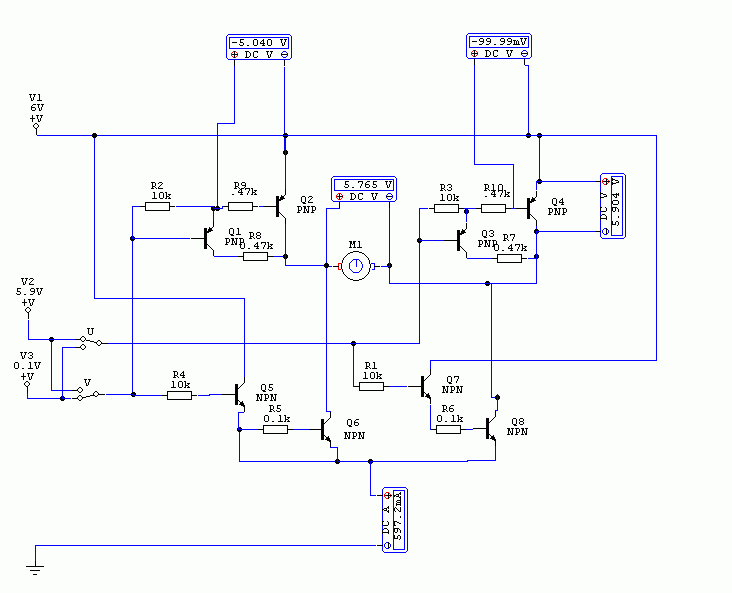

6V DC motor control with transistors
would be something like this?
The input voltages +1.2V and +4.5V are wrong. They should be +0.1V and +5.9V from the microcontroller since the L293 is not needed. Then the transistors that are supposed to be turned off will be turned off.
Your voltmeter shows -2.4V at the base-emitter of Q2 which is impossible.
The base-emitter of Q1 and Q3 do not have a current-limiting resistor in series.
There is no current-limiting resistor between the emitter of Q5 and the base of Q6 because R5 is in the wrong location. R6 is correct.

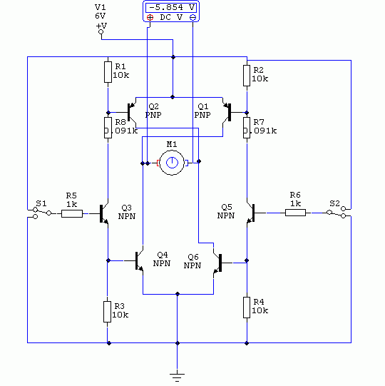

On your new schematic, you have the emitter of Q5 shorted to the emitter of Q6.
You have the PNP transistors connected as a darlington with a 1V loss.
R7 and R8 should be wires.
You have the NPN transistors wired as emitter-followers with a 2.2v loss.
If you replace R1 and R4 with wires then the loss will be "only" 1.7V.

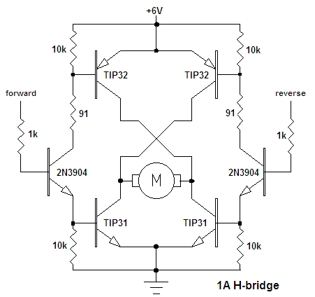

Do it like this:

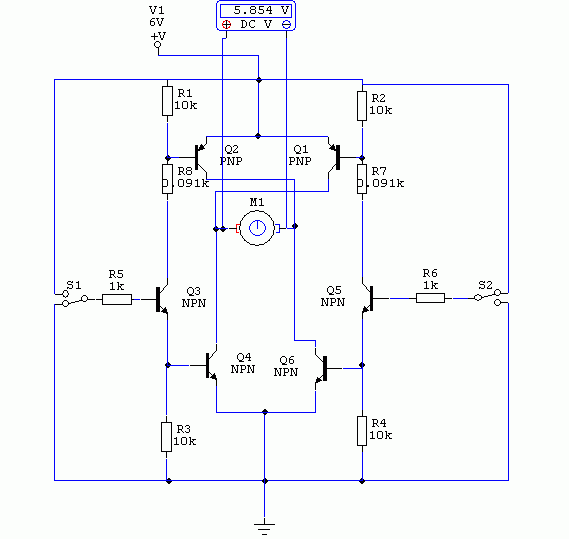

-well, the program is from 2000, should get a newer one...
-Was not meant to do the transistor thing, do it for myself. My as well try MOSFETs.
Case
-ok, went for new software, quite different result.
-tried MOSFETs, got 1 to work, but not the H-Bridgr, tried several from the **broken link removed**.

You got poor results because you used overloaded wimpy little transistors that have a problem with a current more than only 100mA. The motor is trying to draw 2A.
In my circuit I used TIP power transistors that work well with current up to 2A.
